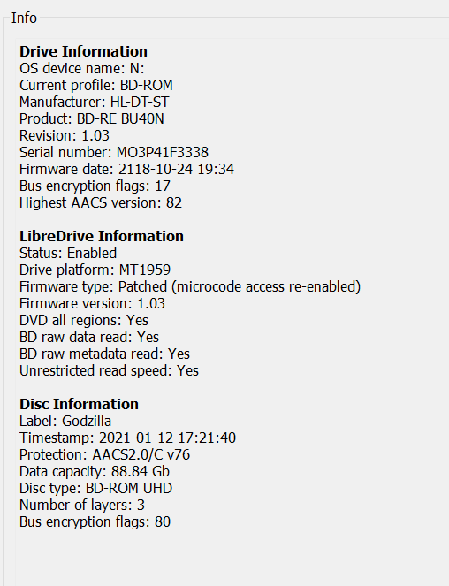

Unfortunately, every single one of your TGZ dump files has the same problem:
SDF  v0a5: HL-DT-ST_BD-RE_BU40N_1.03_211810241934_MO3P41F3338
001011:0000 Using LibreDrive mode (v06.3 id=866A98CB9C4E)
002004:0000 Error 'Scsi error - ILLEGAL REQUEST:COPY PROTECTION KEY EXCHANGE FAILURE - KEY NOT ESTABLISHED' occurred while issuing SCSI command AD010..080002400 to device 'SPTI:\Device\CdRom0'
DEBUG: Code 0 at 2U{2<P"^ib0vfW}i5:213130306
DEBUG: Code 0 at ek0A`ekmmj7(oPSno;:121264395
DEBUG: Code 4 at ek0A`ekmmj7(oPSno;:213130789
003306:0000 Can't read AACS VID from disc - most likely current AACS host certificate is revoked by your drive
Basically, none of these dumps was created with LibreDrive enabled, which makes them unusable :(.
Perhaps you need to wait until the disk has appeared in Windows File Explorer before launching MakeMKV?
Happily for you, all of your disks except for "Godzilla x Kong: The New Empire" already has a complete entry in KEYDB. So once you have managed to enable LibreDrive correctly, could you validate this disk using SamuriHL's KeyDB Helper Utility please? That should complete this final entry.

Well that's just F***in bizarre. I've never had this problem with Libredrive before. It's enabled on the drive (see attached screenshot), but I got that error for every one and assumed it was a missing key. I didn't have this problem a few days ago when I ripped two other UHD discs.
Screenshot 2026-04-01 184531.png (33.69 KiB) Viewed 3518 times
I took your advice and waited until the OS (Windows 11) had recognized Godzilla in the drive and I was able to get MakeMKV to decrypt it. I deselected everything but the movie and had it start ripping it, but it never actually started writing anything to the hard drive.
I restarted the PC, because...sometimes that works.
Tried again. I'm back to my original situation. I can't get MakeMKV to read the thing at all. It's "Parsing file: /AACS/Content001.cer" and "Decrypting". At the 7 minute mark, the drive starts spinning again. Now it's parsing "/AACS/ContentHash001.tbl". it "times out" and I get the errors and it sends me back to the starting screen with the same dump file.
Try again, and I'm getting this:
MakeMKV v1.18.3 win(x64-release) started
Error 'Scsi error - NOT READY:LOGICAL UNIT IS IN PROCESS OF BECOMING READY' occurred while reading 'BD-RE HL-DT-ST BD-RE BU40N 1.03 MO3P41F3338' at offset '33366145024'
udf: node fe/efe failed!
Error 'Scsi error - UNIT ATTENTION:NOT READY TO READY CHANGE, MEDIUM MAY HAVE CHANGED' occurred while reading 'BD-RE HL-DT-ST BD-RE BU40N 1.03 MO3P41F3338' at offset '655360'
udf: UDF mount: disc not properly formatted or damaged disc (rootdirs failing)
Failed to open disc
Right about now, I'm thinking that the drive (which is maybe 6 months old) is bad. Good thing I bought a backup at the same time. So, I put it in the second drive. (Note: Both have been jailbroken and have libredrive.) But it doesn't appear to be the drive. I'm having the same issue. (Changed the USB cable, no difference. Plugged it directly into the PC, rather than the powered USB hub, no difference.) Again, didn't have the problem on Saturday when I ripped the UHD of Rambo: Last Blood.
Maybe this drive just doesn't like Godzilla?!?

Tried a different computer. Same symptoms.
Maybe these are just bad discs. I was able to load and start ripping King Kong: Skull Island. But the rip didn't happen. It never started writing data to the hard drive and the disc just sat there for 10+ minutes before I pulled the plug.
Put in one of the discs I ripped last weekend. It spun right up and behaved as expected.
Not sure whether to do a return/replacement of the 4k, or maybe just buy the bluray version and live with that.

BulldogK9 wrote: Thu Apr 02, 2026 3:14 am Tried a different computer. Same symptoms.
Did you clean the discs? This resolves most read errors unless the drive isn't getting enough power. Use UBS-C if possible and ports direct from the motherboard (not case ports) or an AC self-powered USB hub of at least 24w.

MartyMcNuts wrote: Thu Apr 02, 2026 3:51 am
Discs are brand new and pristine. Didn't spot a single mark on them.
My first attempt was on a high-powered USB hub. The laptop I tried it on was plugged in and fully-juiced. I had no problem popping in other UHD discs and burning them again, just to test the drive. I think that this is just a bad pressing.
Posts: 10961
Re: Public KeyDB Disc Submissions
That wasn't the question. "NEW" DISKS CAN HAVE CONTAMINATION ON THEM.
If the disk was in its packaging for more than 6 months before you tried ripping it, it could have accumulated a film that is difficult to see, but interferes with laser reading.
That's why it is standard practice to recommend cleaning a disk if it's giving trouble with reading.

1. Your discs media key is already known to the public keydb, so the absence of the MKB_RO.inf isn't terminal but your discs keys could've been derived with SamuriHL's KeyDB tool
2. Your discs media key isn't known to the public keydb and it can't be calculated because you failed to include the full MKB_RO.inf file
BulldogK9 wrote: Thu Apr 02, 2026 2:41 am Well that's just F***in bizarre. I've never had this problem with Libredrive before. It's enabled on the drive (see attached screenshot), but I got that error for every one and assumed it was a missing key. I didn't have this problem a few days ago when I ripped two other UHD discs.
Whilst MakeMKV describes the LibreDrive status as 'Enabled' a more accurate label would probably be 'Capable' or 'Supported'. LibreDrive requires microcode extensions to run on your drive. If a drive encounters a firmware issue, certain timeouts or transient power faults, they can effectively self-reboot and end up in the non-LibreDrive state that you observed.
