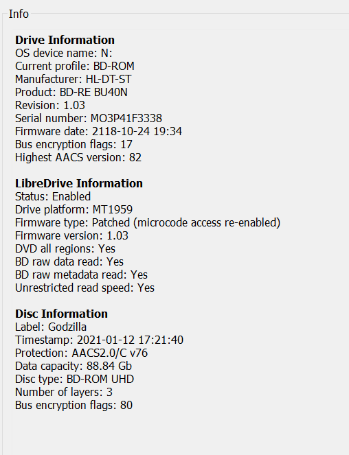

Re: Godzilla (2014) Mosterverse 5 Disc Set
Unfortunately, every single one of your TGZ dump files has the same problem:BulldogK9 wrote: Wed Apr 01, 2026 7:44 pm Disc ID: 0ddf5098532dbe9c3095e9ebe610b2ca9268e940
Disc dump filename: MKB20_v77_Godzilla_x_Kong-_The_New_Empire_9C31.tgz
SDF v0a5: HL-DT-ST_BD-RE_BU40N_1.03_211810241934_MO3P41F3338
001011:0000 Using LibreDrive mode (v06.3 id=866A98CB9C4E)
002004:0000 Error 'Scsi error - ILLEGAL REQUEST:COPY PROTECTION KEY EXCHANGE FAILURE - KEY NOT ESTABLISHED' occurred while issuing SCSI command AD010..080002400 to device 'SPTI:\Device\CdRom0'
DEBUG: Code 0 at 2U{2<P"^ib0vfW}i5:213130306
DEBUG: Code 0 at ek0A`ekmmj7(oPSno;:121264395
DEBUG: Code 4 at ek0A`ekmmj7(oPSno;:213130789
003306:0000 Can't read AACS VID from disc - most likely current AACS host certificate is revoked by your drivePerhaps you need to wait until the disk has appeared in Windows File Explorer before launching MakeMKV?
Happily for you, all of your disks except for "Godzilla x Kong: The New Empire" already has a complete entry in KEYDB. So once you have managed to enable LibreDrive correctly, could you validate this disk using SamuriHL's KeyDB Helper Utility please? That should complete this final entry.
Re: Public KeyDB Disc Submissions
Well that's just F***in bizarre. I've never had this problem with Libredrive before. It's enabled on the drive (see attached screenshot), but I got that error for every one and assumed it was a missing key. I didn't have this problem a few days ago when I ripped two other UHD discs.
I took your advice and waited until the OS (Windows 11) had recognized Godzilla in the drive and I was able to get MakeMKV to decrypt it. I deselected everything but the movie and had it start ripping it, but it never actually started writing anything to the hard drive.
I restarted the PC, because...sometimes that works.
Tried again. I'm back to my original situation. I can't get MakeMKV to read the thing at all. It's "Parsing file: /AACS/Content001.cer" and "Decrypting". At the 7 minute mark, the drive starts spinning again. Now it's parsing "/AACS/ContentHash001.tbl". it "times out" and I get the errors and it sends me back to the starting screen with the same dump file.
Try again, and I'm getting this:
Maybe this drive just doesn't like Godzilla?!?
Right about now, I'm thinking that the drive (which is maybe 6 months old) is bad. Good thing I bought a backup at the same time. So, I put it in the second drive. (Note: Both have been jailbroken and have libredrive.) But it doesn't appear to be the drive. I'm having the same issue. (Changed the USB cable, no difference. Plugged it directly into the PC, rather than the powered USB hub, no difference.) Again, didn't have the problem on Saturday when I ripped the UHD of Rambo: Last Blood.MakeMKV v1.18.3 win(x64-release) started
Error 'Scsi error - NOT READY:LOGICAL UNIT IS IN PROCESS OF BECOMING READY' occurred while reading 'BD-RE HL-DT-ST BD-RE BU40N 1.03 MO3P41F3338' at offset '33366145024'
udf: node fe/efe failed!
Error 'Scsi error - UNIT ATTENTION:NOT READY TO READY CHANGE, MEDIUM MAY HAVE CHANGED' occurred while reading 'BD-RE HL-DT-ST BD-RE BU40N 1.03 MO3P41F3338' at offset '655360'
udf: UDF mount: disc not properly formatted or damaged disc (rootdirs failing)
Failed to open disc
