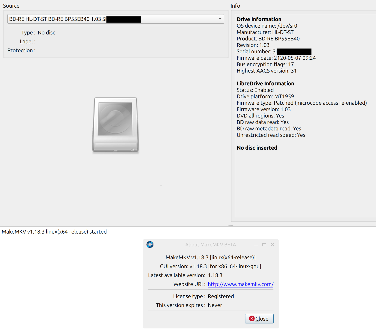

Thanks for the extensive guide and provided ressources. I've been using MakeMKV for some years now and it's been great.
Some time ago I patched my drive (BP55EB40) but just now got my hands on a UHD disk to try ripping that. The drive is searching the disk for about 2 minutes and then MakeMKV shows no disk inserted.
Is this related to the sleep error? How can I fix this?
The screenshot is from Linux but I am experiencing the same behavior on Windows and with another disc too. FHD Blu rays can be ripped without any problem at up to 6x speeds from what I've seen so far.
Thanks in advance!
The same error exists on Win11

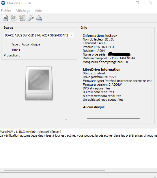

Which firmware for the ASUS BW-16D1H-U PRO please ? I also have issue with Nero Burning rom (a better software ?) which doesn’t detect my device :? maybe need a driver I don’t have, just the default Windows one.
Thanks.
Posts: 6149
Maskman wrote: Sun Mar 29, 2026 10:15 pm Hi,
Thanks.
Flash to wh16ns60

Maskman
Joined: Sun Mar 29, 2026 4:25 pm
Post by Maskman »
Billycar11 wrote: Mon Mar 30, 2026 1:51 am
Thanks.
Flash to wh16ns60
Thanks ! Which version please ? There is different versions of wh16ns60.
Posts: 6149
Maskman wrote: Mon Mar 30, 2026 10:18 pm
Thanks.
Flash to wh16ns60
I recommend 1.02 or 1.00
