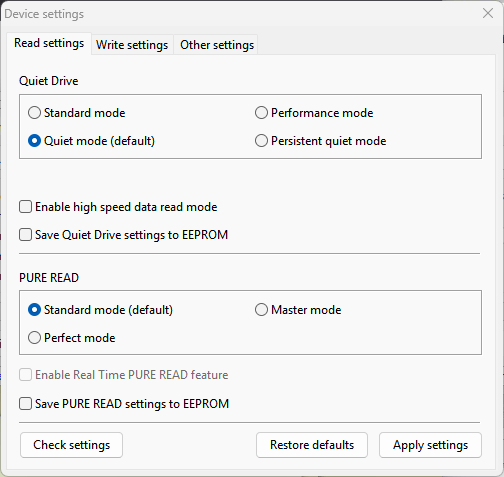

Do you have any recommendations for changing the settings? Or would you just leave them alone?
Specifically I'm wondering if any of these meaningfully impact longevity or read performance/reliability.
