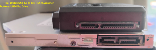

I have an adapter like Marty suggested (unfortunately, none of the ones that he suggested are in stock):
But I still can't connect the two.
From what Marty said, there is a power issue and I should use direct AC power (e,g, not via my PC's power supply).

That unitek one should be fine. Just add a sata to mini sata adaptor and you should be good. I linked to it in my previous post.
