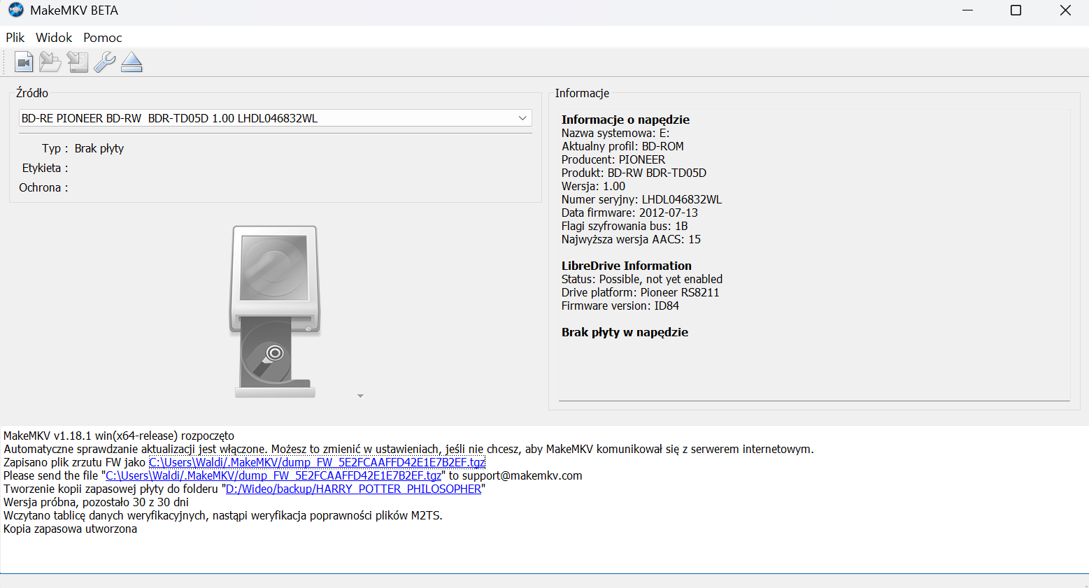

Hello everyone.
Can someone tell me why my bdrom (Pioneer BDR-TD05) cannot read 4K UHD drives? screen from MakeMKV added
- makeMKV screen.png (99.41 KiB) Viewed 46757 times
- Posts: 4985
UHD discs are not the same as regular blu-ray discs. A drive must have libredrive enabled and be on a UHD compatible firmware to be able to read UHD discs. 99.9% of the time this means the drive must be flashed.mwalda wrote: Fri Jul 25, 2025 9:16 pm Hello everyone.
I think your's may be able to have libredrive enabled (for blu-ray only) but will never be compatible with UHD discs.

Ah, thank you for the clarification and for your helpCoopervid wrote: Mon Jul 21, 2025 10:16 am Sorry! There have been a few cases when I oversaw 8591 instead of 8511 since both are listed as UD03 or US03.
Well, I bought this TD05 model because it was on the "Pioneer" list. Are you sure it will not be able to read UHD drives?MartyMcNuts wrote: Fri Jul 25, 2025 11:58 pmUHD discs are not the same as regular blu-ray discs. A drive must have libredrive enabled and be on a UHD compatible firmware to be able to read UHD discs. 99.9% of the time this means the drive must be flashed.mwalda wrote: Fri Jul 25, 2025 9:16 pm Hello everyone.
- Posts: 4985
On what Pioneer list??mwalda wrote: Sat Jul 26, 2025 5:36 amWell, I bought this TD05 model because it was on the "Pioneer" list. Are you sure it will not be able to read UHD drives?MartyMcNuts wrote: Fri Jul 25, 2025 11:58 pmUHD discs are not the same as regular blu-ray discs. A drive must have libredrive enabled and be on a UHD compatible firmware to be able to read UHD discs. 99.9% of the time this means the drive must be flashed.mwalda wrote: Fri Jul 25, 2025 9:16 pm Hello everyone.
If you are referring to the list in the first post of this very thread, that is only to enable libredrive, not UHD disc readability. They are 2 totally different things. If you are referring to the Ultimate UHD Drives Flashing Guide Updated 2025, it is not on the list of UHD capable drives.
Ok, thanks. That is now very clear to me.MartyMcNuts wrote: Sat Jul 26, 2025 7:29 amOn what Pioneer list??mwalda wrote: Sat Jul 26, 2025 5:36 amWell, I bought this TD05 model because it was on the "Pioneer" list. Are you sure it will not be able to read UHD drives?MartyMcNuts wrote: Fri Jul 25, 2025 11:58 pm
