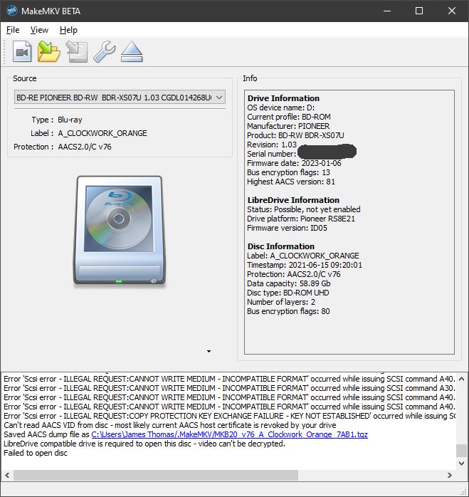

PeterMac wrote: Thu Apr 10, 2025 6:40 pm Zrzut ekranu 2025-04-10 193734.png
Any chance to downgrade to 1.03 ?
come on peter you have been messaging me and asmcom for weeks then you buy this you knew this would be the case your are out of luck for now
it will happen eventually but not today

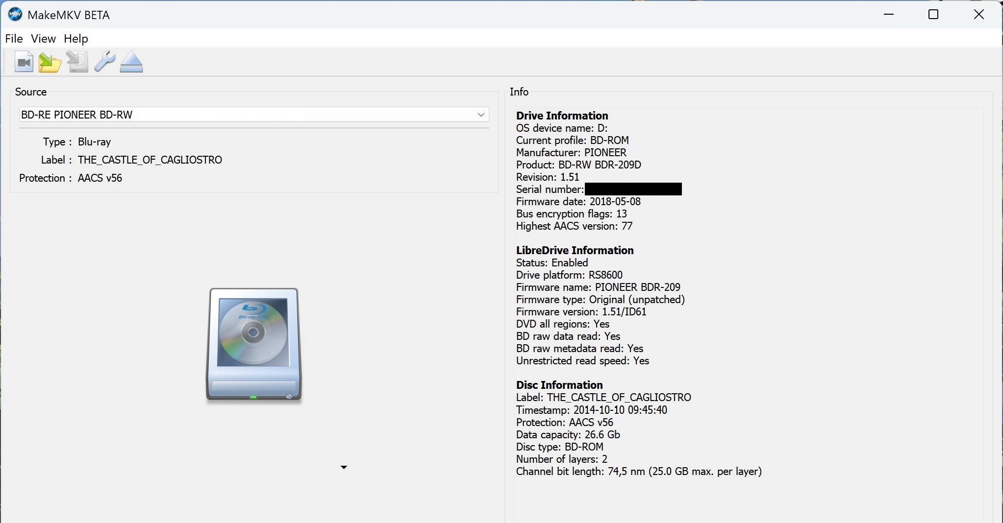

Hi Everyone. I recently got a BDR-S12U for UHD disks before coming across this thread and discovering it has the dreaded Dec 2022 firmware, which I see has hobbled LibreDrive functionality. I'll put this back in the box until the day comes where there is a LibreDrive breakthrough...
The drive I was using previously is Pioneer BDR-209D. Judging by some posts here, it looks like there might be hope of using this for 4k UHD disks and LibreDrive mode. Am I in luck with this drive? Screenshot shows standard BD, UHD disks don't show up with anything. Thanks!
Posts: 4815
Post by Coopervid » Tue Apr 22, 2025 7:47 pm
mirage26 wrote: Tue Apr 22, 2025 12:48 pm Hi Everyone. I recently got a BDR-S12U for UHD disks before coming across this thread and discovering it has the dreaded Dec 2022 firmware, which I see has hobbled LibreDrive functionality. I'll put this back in the box until the day comes where there is a LibreDrive breakthrough...
PM sent.
mirage26
Joined: Tue Apr 22, 2025 12:24 pm
Post by mirage26 » Wed Apr 23, 2025 11:56 am
Coopervid wrote: Tue Apr 22, 2025 7:47 pm
PM sent.
WOW...that did it!! :D Thank you very much, your efforts won't go unrewarded. I wish you all the best (PS. I don't yet have ability to respond to PM directly).

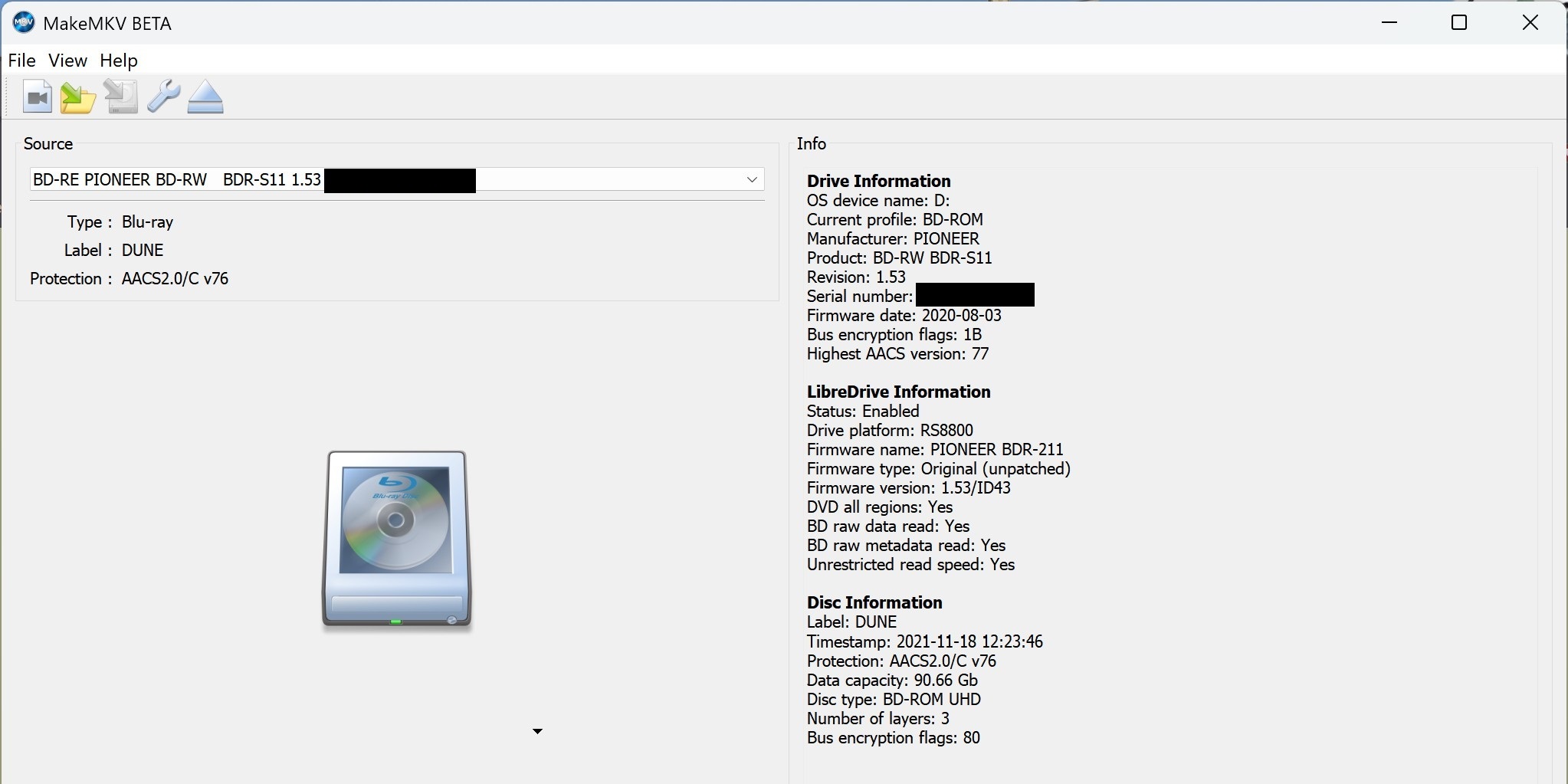

A screenshot of failure to open drive (works well with other formats):
