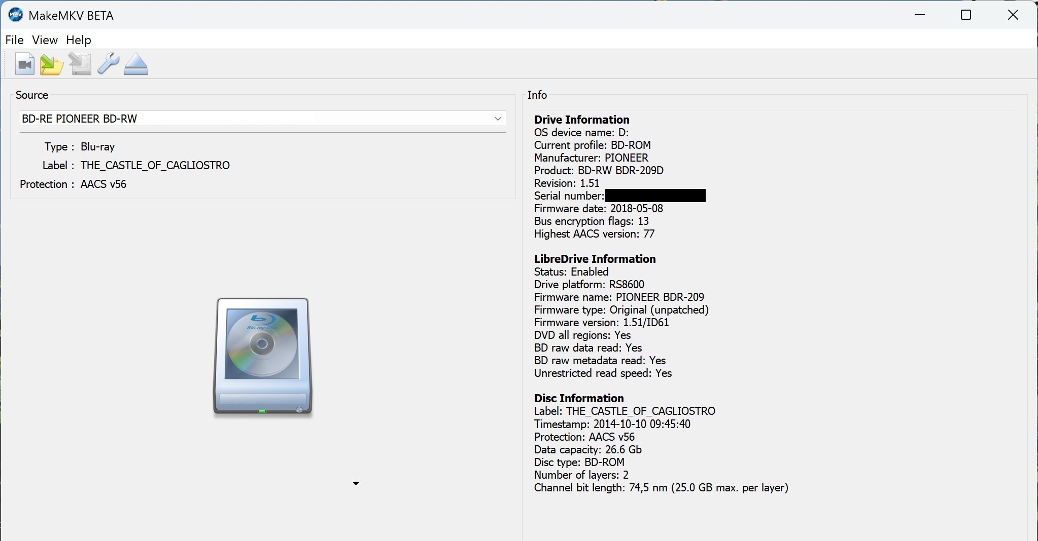

The drive I was using previously is Pioneer BDR-209D. Judging by some posts here, it looks like there might be hope of using this for 4k UHD disks and LibreDrive mode. Am I in luck with this drive? Screenshot shows standard BD, UHD disks don't show up with anything. Thanks!
- BDR-209D_info.jpg (243.7 KiB) Viewed 18792 times
PM sent.mirage26 wrote: Tue Apr 22, 2025 12:48 pm Hi Everyone. I recently got a BDR-S12U for UHD disks before coming across this thread and discovering it has the dreaded Dec 2022 firmware, which I see has hobbled LibreDrive functionality. I'll put this back in the box until the day comes where there is a LibreDrive breakthrough...
WOW...that did it!!Coopervid wrote: Tue Apr 22, 2025 7:47 pmPM sent.mirage26 wrote: Tue Apr 22, 2025 12:48 pm Hi Everyone. I recently got a BDR-S12U for UHD disks before coming across this thread and discovering it has the dreaded Dec 2022 firmware, which I see has hobbled LibreDrive functionality. I'll put this back in the box until the day comes where there is a LibreDrive breakthrough...

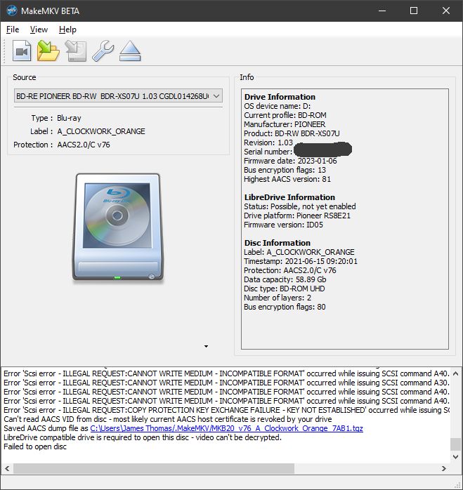

A screenshot of failure to open drive (works well with other formats):
