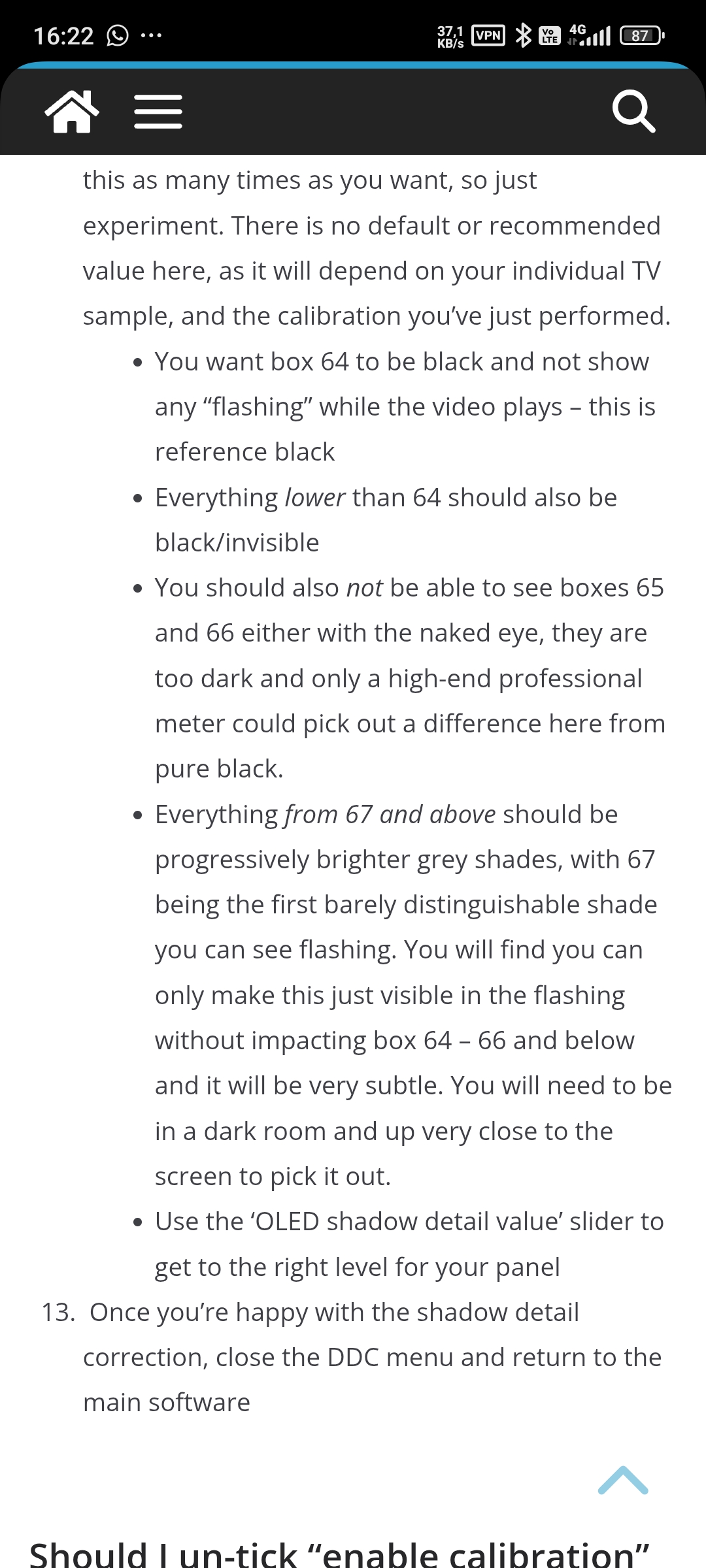

Do these rules apply to all SDR, HDR10 and DV? Because from the TVs I own, it seems HDR10 & DV always crush black more than SDR.daffie wrote: Sun Apr 27, 2025 10:21 pmWrong.RESET_9999 wrote: Sat Apr 26, 2025 4:05 pmIf I'm not mistaken, you should see 66–67 flashing from a normal distance, and 65 only when looking about one foot away from the screen. Of course, all of this is in a dark room without lights.deadchip12 wrote: Sat Apr 26, 2025 2:42 pm Just used your files to test black crush.
SDR looked the most accurate—I could see all the flashing bars up to 65 from my seat (1.2m from the 65-inch TV). HDR10 crushed blacks more; in order to see the 65 bar, I had to move my face closer to the screen.
Dolby Vision was by far the worst—I could barely see past the 90 bar.
Then, I realized why. A few months ago, an update caused black screens in Dolby Vision to no longer appear as true black. Based on recommendations from forum users, I lowered the RGB-Bias to -4 in the advanced color settings to counteract this. When I raised it back from -4 to 0, I could see the bars up to 67 if I moved closer to the screen. So, it still crushes blacks more than HDR10 but is better. The problem is that black is no longer true black again.
Do you have any solutions for this?
Bar 64 is reference black. Bar 64 and everything below it should be black. Bar 65 and 66 should also be impossible to see it flashing. The first visible bar should be 67. But barely with your nose on the screen. This is all written down in the Calman calibration guide you can find on the Internet.
@deadchip12
Yes, the rules are the same for SDR, HDR and DoVi.

Did some testing in very dark room.RESET_9999 wrote: Mon Apr 28, 2025 10:40 ameven in cmv4.0 ??? cmv2.9 will be crushed no matter whatdaffie wrote: Mon Apr 28, 2025 8:13 am
My black levels in SDR are ok, but in HDR the 65-66 bar is visible and in DoVi I'm not seeing bar 67+68... So I'm missing shadow details in DoVi.
Calibrated SDR : flashing bar from 67 onwards. That's perfect.
Calibrated HDR: flashing bar from 65 onwards. That's raised blacks. Uncalibrated HDR is exactly the same.
Uncalibrated Dovi cm 2.9: flashing bar from 68 onwards. But the first is barely visible you have to get your nose on the screen and even then it's really faint.
Uncalibrated Dovi cm 4.0: flashing bar from 65 onwards. Again 65 very faint.
Calibrated Dovi was awful with first bar somewhere in the low 70's visible. So I reset that to default.
So indeed Dovi cm 4.0 is kind of perfect in terms of black level. Better than 2.9 for sure.
