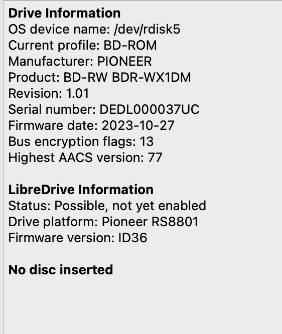

Hello! I'm new to this forum, so excuse my ignorance. I just got a new Pioneer drive off of Amazon that I can't find mentioned anywhere on this site. Anyone know if this Pioneer BDR-WX01DMU can unlock LibreDrive and rip UHD?
OS device name: /dev/rdisk5
Manufacturer: PIONEER
Product: BD-RW BDR-WX1DM
Revision: 1.01
Serial number: ...
Firmware date: 2023-10-27
Bus encryption flags: 13
Highest AACS version: 77
Drive platform: Pioneer RS8801
Firmware version: ID36
I sent this info to the MakeMKV support email, but I'm not sure exactly who gets those email? Thanks for any help!

- Screenshot 2025-03-26 at 5.49.26 PM.png (82.47 KiB) Viewed 16571 times
- Posts: 4983
No it cannot. The issue is the firmware is post 11/2022 and is therefore not updatable for libredrive or UHD.bradh1 wrote: Wed Mar 26, 2025 11:44 pm Hello! I'm new to this forum, so excuse my ignorance. I just got a new Pioneer drive off of Amazon that I can't find mentioned anywhere on this site. Anyone know if this Pioneer BDR-WX01DMU can unlock LibreDrive and rip UHD?

Gotcha, thank you Marty! I was actually just reading about that a little while ago. I also came across your posts listing UHD friendly drives for sale. Do you ship to the US?
