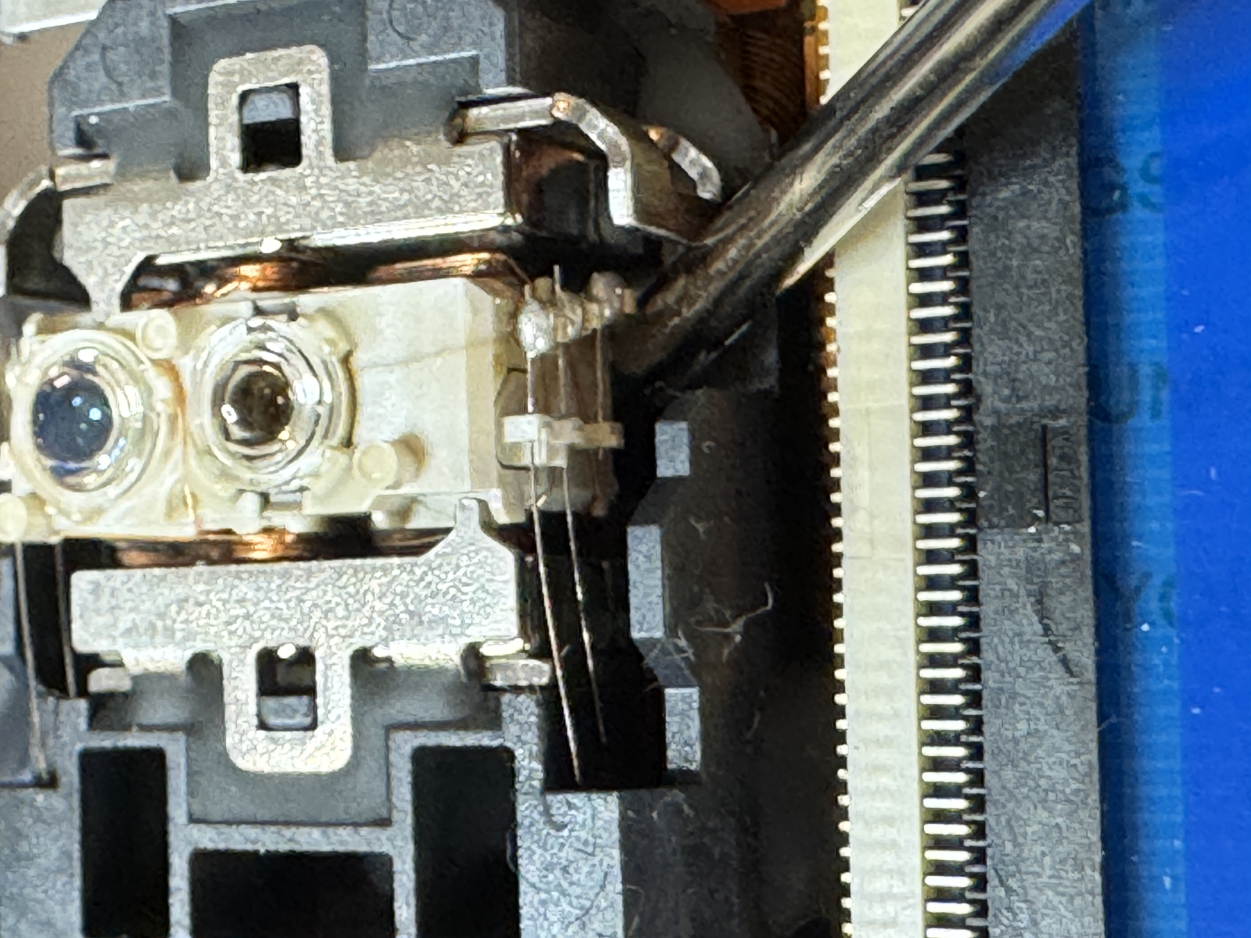

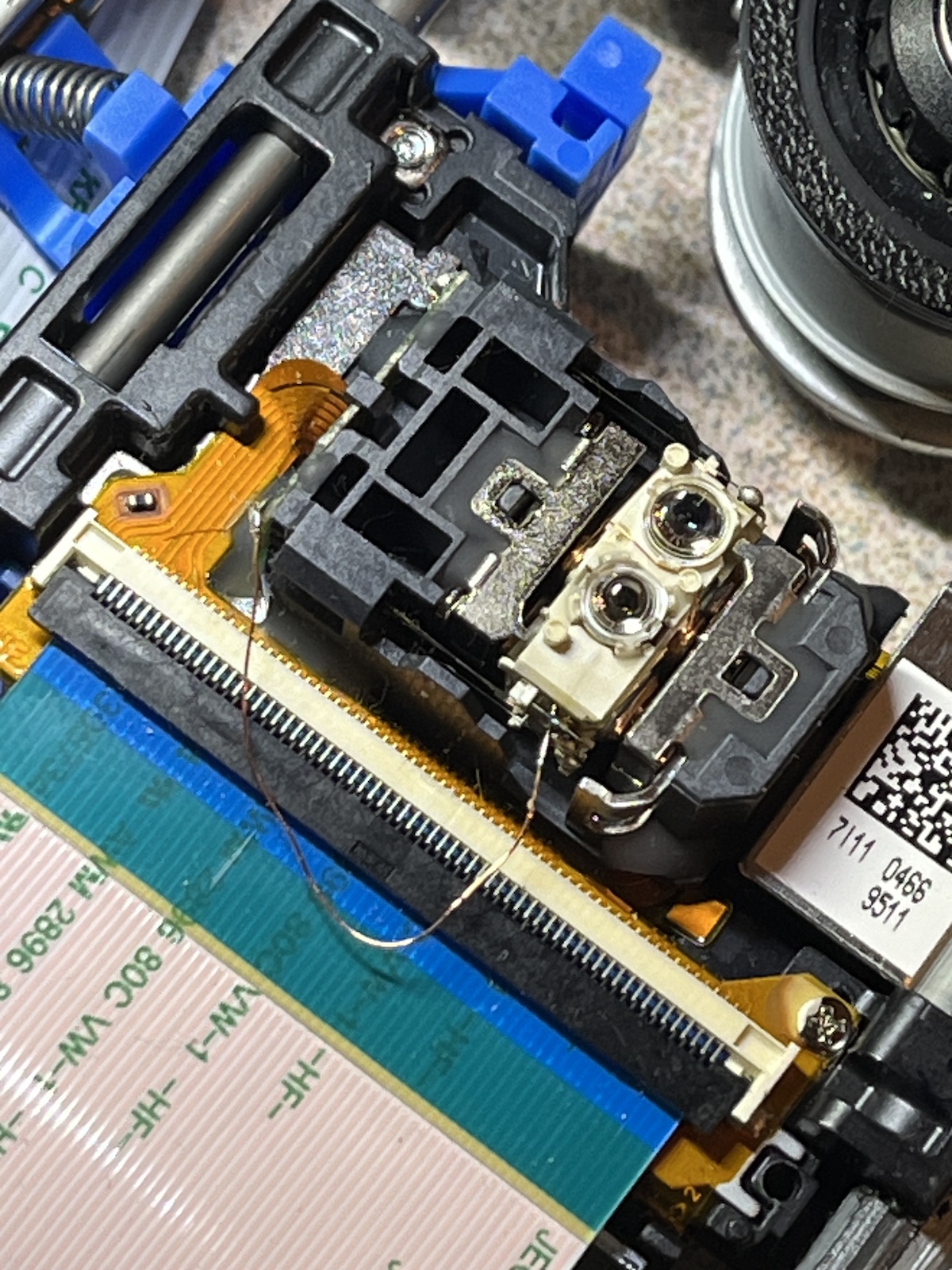

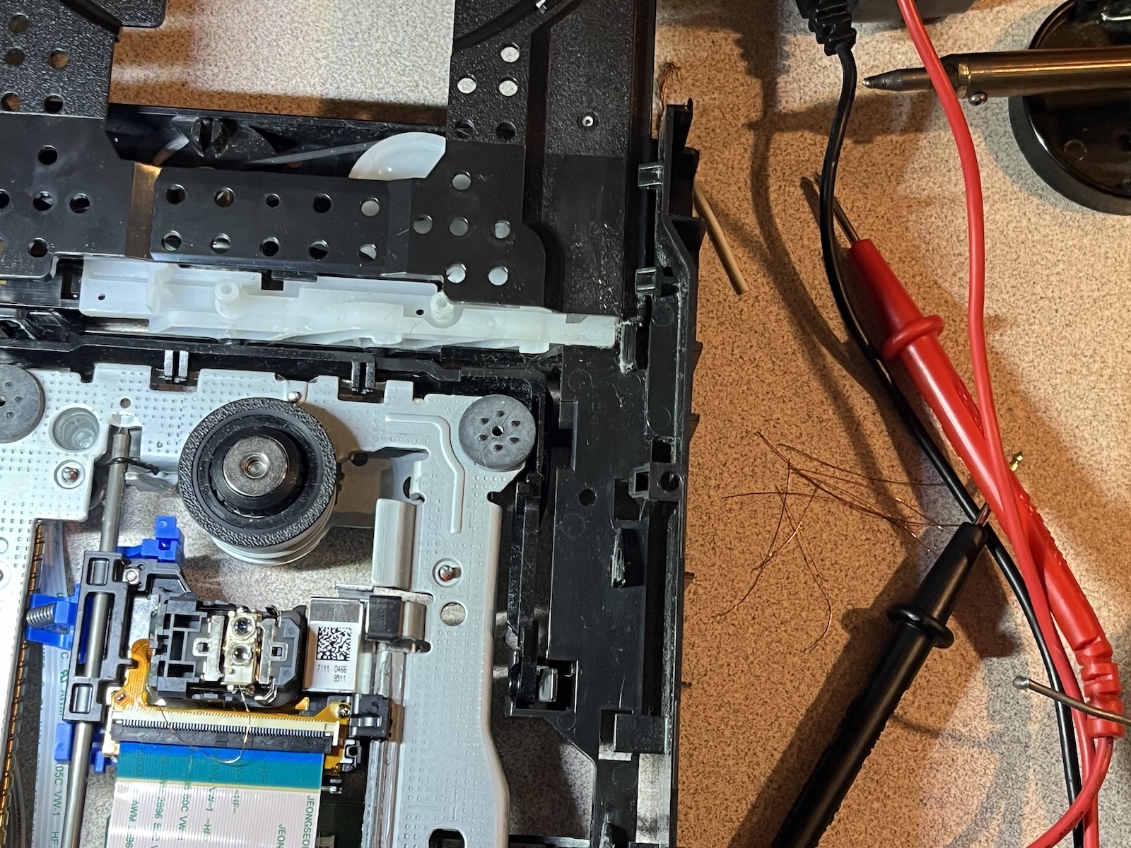

Made an account here just so I could thank you for this. My WH16NS40 in a Mercury Pro enclosure was dead today when I went to use it for the first time in a couple months. Lights blink, disk spins up a for a second or two, then stops; does that three times, then spits the disk out. I bought the drive new in 2018, and honestly have used it twice as much for CD ripping as I have for Blu-rays, but it's been well-cared-for, fast and reliable for all purposes...up until today.
In any case, I found your post here while researching what might be wrong, and sure enough, top right wire was snapped right at that same plastic wire guide on the laser head assembly of mine. I've got a different project all spread out on my actual workbench right now, so I brought the 15w iron up to the kitchen counter, stole an inch of ~24 gauge stranded from a surround speaker connection wire in the living room and stripped it to a pile of strands, grabbed my strongest readers and gave it a shot. It's not pretty, but it works like a charm again. Tested CD/DVD/BD, all are working great. Not pictured below is the little piece of tape I put over those ribbon contacts underneath the bodge to prevent any shorts. Thanks so much for the show-and-tell!
The breach:
Kitchen counter fix-it shop:
Fixed!
The breach:
Fixed!

It's honestly crazy to me that the design of this is such that those six little wires, each barely thicker than a human hair, are not only providing the critical electrical connections to the lasers but seem to be providing all the structural support for the head as well. Not sure how they don't just break after the first couple hours of use, frankly.
One other thing I forgot to mention — when I first disassembled mine, I started by removing only the bottom plate, and then turned it on and ran a disc in there so I could watch what was happening. I saw both of the lasers fire off just fine each time it tried to spin up, so I'm guessing that this particular broken wire (topmost of the three on the side facing the ribbon cable) is part of the signal chain that's passing "read" info back, rather than, say, powering the laser(s) up.

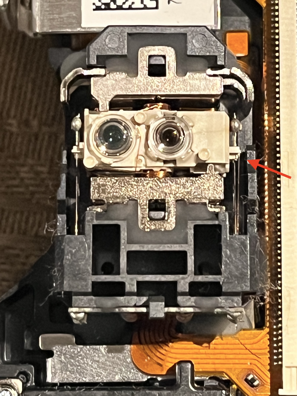

Re: A FIX: LG WH14NS and WH16NS (soldering required)
Hard for me to get a meter on to check continuity without a third hand, but looks like the bottom wire of the three on the same side of the laser assembly as you guys is broken on my drive. Seems like a job for Ant Man, but I will give it a go!
