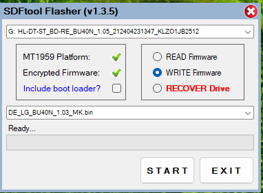

My SDFtool flasher v1.3.5 does not show the option to select enc Is there another version of the program?
- Posts: 4837
Re: Problem with new LG BH16NS55SO
It is selected. The green check mark at "Encrypted firmware". You have no idea what you were doing and should't have it done the first place.jmrrsa wrote: Wed Nov 20, 2024 7:25 pm Thanks
