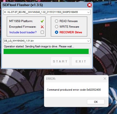

1. Drive is closed and no disc is inserted.
2. Drive is connected to a modern PC with a powered SATA to US3 convertor.
As I was advised to do a recovery could I be choosing the incorrect "wrong" firmware?
Screenshot 2023-04-09 202959.jpg (57.63 KiB) Viewed 17607 times
Posts: 5803
Re: SDFtool Flasher
mike23 wrote:
Mon Apr 10, 2023 3:58 am
Billycar11 wrote:
Mon Apr 10, 2023 2:18 am
mike23 wrote:
Mon Apr 10, 2023 2:12 am
no you need this download/file.php?id=3036
I appreciate the help Billycar11!
i guess you will have to do dosflash then see my recovery section likly cant do it on a modern pc and wont work over usb

Flash: DE_LG_BP50NB40-NB50_1.03_MK.bin
Hit Start, it runs, looks like it was happy.
MakeMKV drive info shows nothing different. Should it at this step?
Step 2
RECOVER
Select this drive again:
D: HL-DT-ST_BD-RE_BP50NB40_1.03_212005070917
MT1959 Platform: Green Check
Encrypted Firmware: Red X
Include boot loader? Box not checked
Step 3
WRITE
Flash: DE_LG_BP60NB10_1.00_MK.bin
MakeMKV drive info shows nothing different. It definitely should at this point, right?!
Sorry if I'm being dense here, the original steps seem so straight forward but this drive doesn't seem to budge when I look at the Make MKV drive info.
Do I need to return this one and try another? Thanks in advance for any help here, very frustrated....
try my guide method
