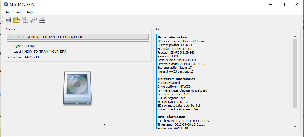

Here's what MakeMKV shows.
Just got the windows machine set up.

SDF Gui says it's not the right platform to flash it. I've managed to flash the original firmware back onto it using a tool from the LG site.
MakeMKV is now showing the below. If it rips OK I'll leave it as is. I bought it off eBay where it's been mislabled so i'll try and get my money back. Not what i was intending to buy. I already have a drive that can read blu-rays. I was looking for a new UHD drive. I had the LG BU40N previously and it was fine but the form factor annoyed me.
