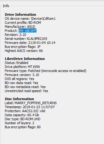

Hi all, bought a BW-16D1HT and flashed it with "ASUS-BW-16D1HT-3.10-WM01601-211901041014.bin" successfully.
However, I cannot read UHD disks. I put them in, it shows the Blu-Ray icon, but when I click into the disk to read it I get the error "The volume key is unknown for this disc - video can't be decrypted" for every disk:
MakeMKV v1.17.3 win(x64-release) started
Using LibreDrive mode (v06.3 id=0FA242DD4D0B)
Using direct disc access mode
Saved AACS dump file as C:\Users\David/.MakeMKV/MKB20_v61_Coco_C4E3.tgz
Failed to open disc
Failed to open disc
Saved AACS dump file as C:\Users\David/.MakeMKV/MKB20_v66_Mary_Poppins_Returns_F89D.tgz
Failed to open disc
Saved AACS dump file as C:\Users\David/.MakeMKV/MKB20_v61_Spider-Man-_Into_the_Spider-Verse_F9ED.tgz
Failed to open disc
I am sure I am doing something dumb. Help!

Traveler2032 wrote: Sun Feb 26, 2023 8:41 pm Hi all, bought a BW-16D1HT and flashed it with "ASUS-BW-16D1HT-3.10-WM01601-211901041014.bin" successfully.

Make sure that "Allow internet access" is checked in MakeMKV Settings.

asmcom wrote: Mon Feb 27, 2023 1:17 am Asmcom :mrgreen:
This was ultimately the issue. Thanks for the assistance.
