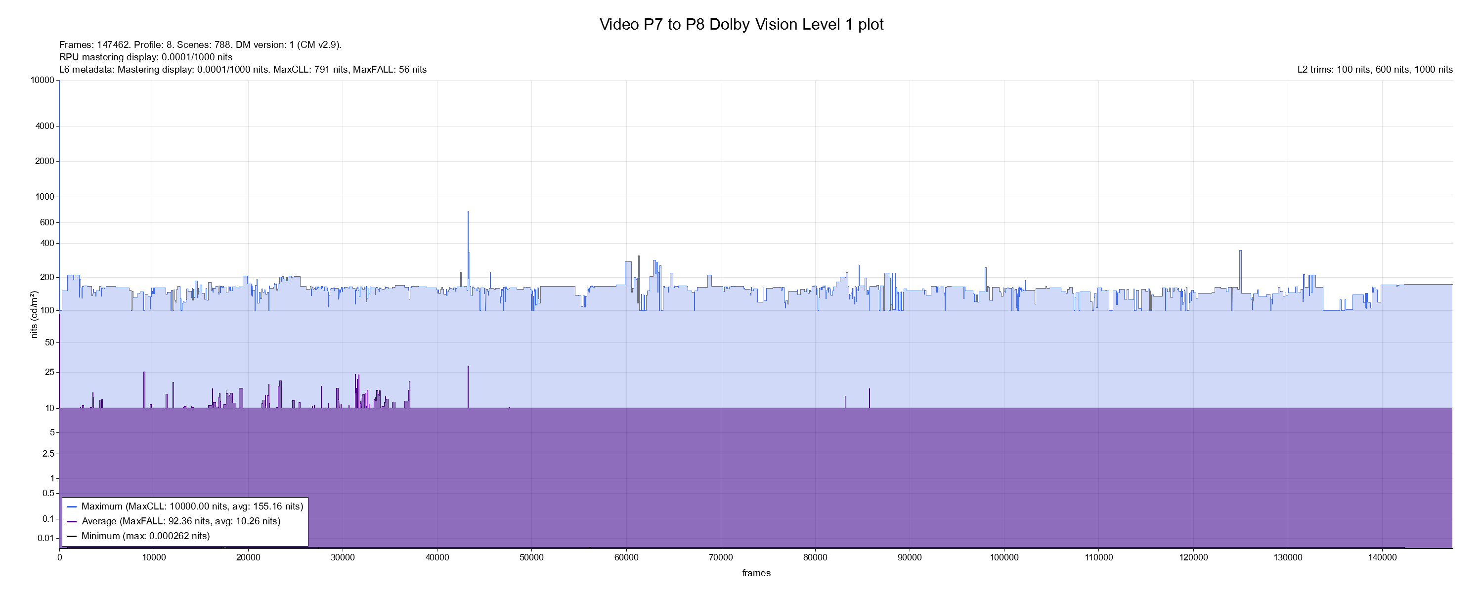

@RESET_9999
Is this a video that might benefit from a Resolve generated RPU? Original file is BL+FEL+RPU.
Video P7 to P8_DoVi_plot.png (105.43 KiB) Viewed 14443 times

Posts: 2405
Gatorman wrote:
Wed Mar 01, 2023 8:02 pm
@RESET_9999
not sure i understand your question... Why would you generate DV when you have the original retail metadata?
Gatorman
Posts: 81
Post by Gatorman »
RESET_9999 wrote:
Wed Mar 01, 2023 8:36 pm
That's fair. Is it common to see an "Average" line flat for so long?
More reasons to collect physical media. Ugoos AM6B+.
Posts: 2405
Gatorman wrote:
Wed Mar 01, 2023 9:16 pm
yes and you would get the same metadata with resolve.
AS long as it's not static or incorrect, the graph (L1) is supposed to be a perfect representation of the HDR grade.
