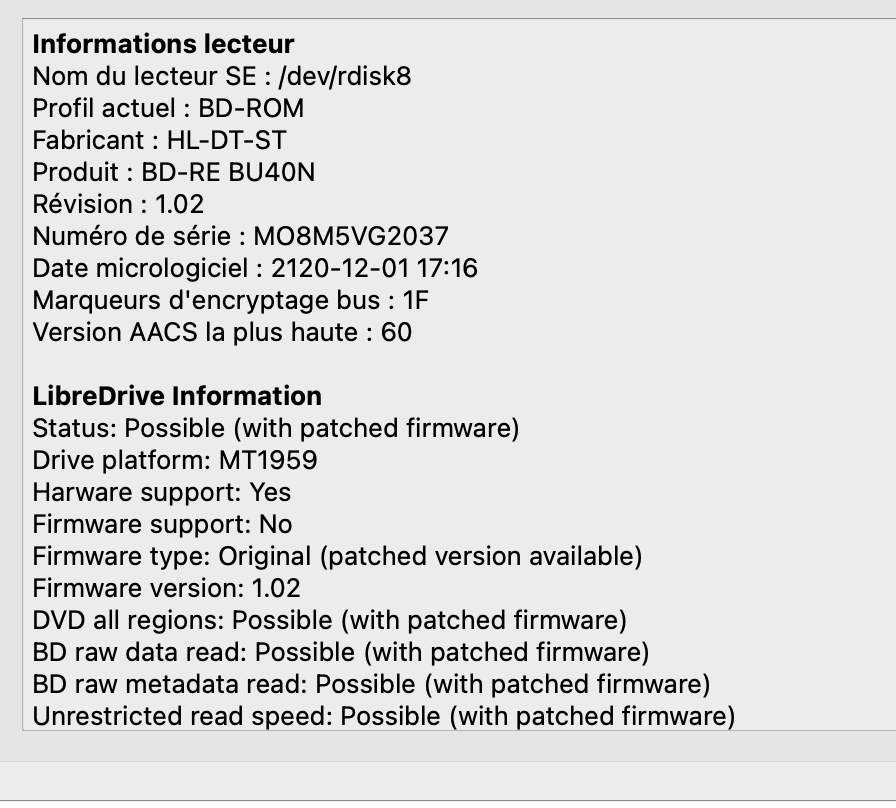

Bonjour,
Impossible de ripper mon blu-ray UHD "The Revenant"; voici le message :
Capture d’écran 2023-02-07 à 18.14.40.png (141.86 KiB) Viewed 6981 times
J'ai entendu parler de patch, que dois-je faire?
Merci

Guytoon wrote: Tue Feb 07, 2023 5:28 pm Good morning,
heard about patch, what should I do?
THANKS
Flashing firmware on a Mac for LibreDrive
BU40N on any Firmware directly to > BU40N 1.03MK
Ultimate UHD Drives Flashing Guide Updated 2023

My reader is a Archon UHD...

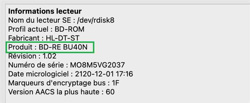

Guytoon wrote: Tue Feb 07, 2023 6:24 pm My reader is a Archon UHD...
Capture d’écran 2023-02-07 à 18.14.40 (Small).png (77.34 KiB) Viewed 6969 times
FW v1.02 is on the 'encrypted' list, so use the command line example containing 'enc'.
