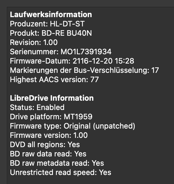

This looks like the right tool for me, however, I can't flash my drive. The error message is that I don't have the right platform (MT1959). When I check the platform with MakeMKV, it tells me that the platform is MT1959. Any idea what the mistake could be?
Bildschirm­foto 2023-01-05 um 15.55.23.png (93.01 KiB) Viewed 18644 times
Posts: 5070
Re: SDFtool Flasher
MeyroNW wrote: Thu Jan 05, 2023 2:59 pm This looks like the right tool for me, however, I can't flash my drive. The error message is that I don't have the right platform (MT1959). When I check the platform with MakeMKV, it tells me that the platform is MT1959. Any idea what the mistake could be?
Your drive is already libredrive enabled, so no need to flash it.

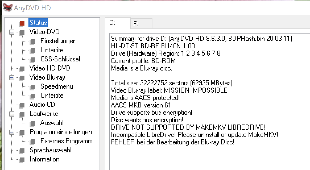

Thanks for your fast reply Marty, but why then do I get the following error message in Anydvd HD?
Bildschirm­foto 2023-01-05 um 20.33.39.png (79.33 KiB) Viewed 18631 times
Posts: 4740
Re: SDFtool Flasher
Your version of Makemkv is outdated. Please update.
