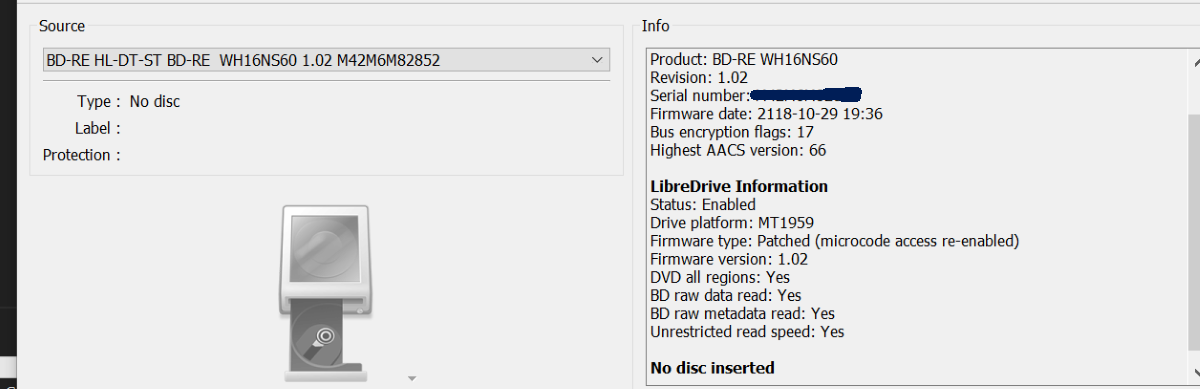

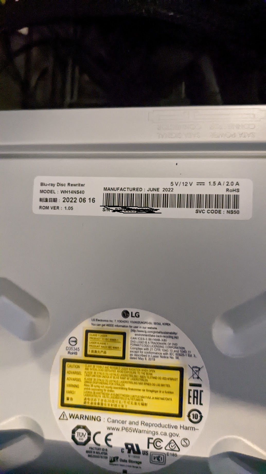

I found a LG WH14NS40 Rom ver 1.00 Made June 2013 for 45.00 CND Plus G
would this work or should buy a new one I can get a New LG WH14NS40 for 100 CND
I'm comfortable with flashing it myself since I've Flash motherboard's before and this doesn't seem much different
And the software looks fairly straightforward

WH14NS40 Blueray drive flash with WH16BS60 Ver 1.03

Any drive from 2013 would NOT work for UHD, because it was built 2 years prior to UHD being defined.
It would work for DVD and BD, but you can buy new drives for that price that only does those.
I ended up rolling the dice on a new one and it looks like it paid off
so far it work on DVD and Blue rays I've ordered a Ultra Blu-ray to test tomorrow
I want to thank everyone for the great guides on doing this it's been very helpful

SHould I update from 1.02 to Firmware version: 1.03 firmware ?

Just an update was able to do the 4K UHD discs without any problem. Again thanks to everyone
