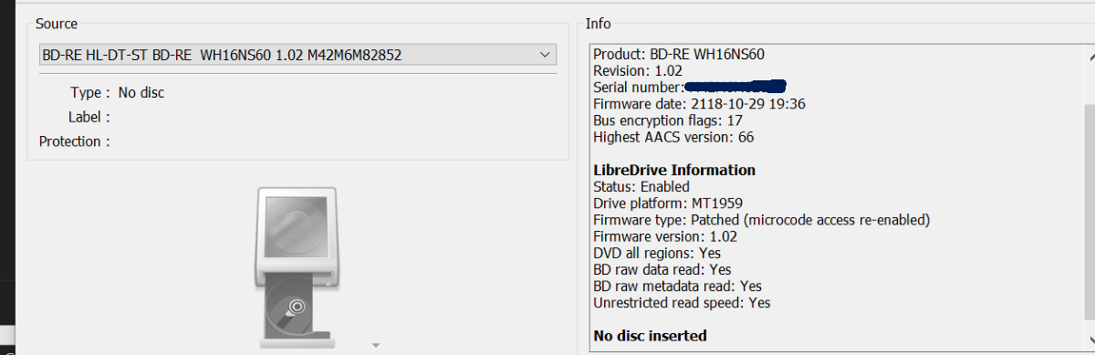

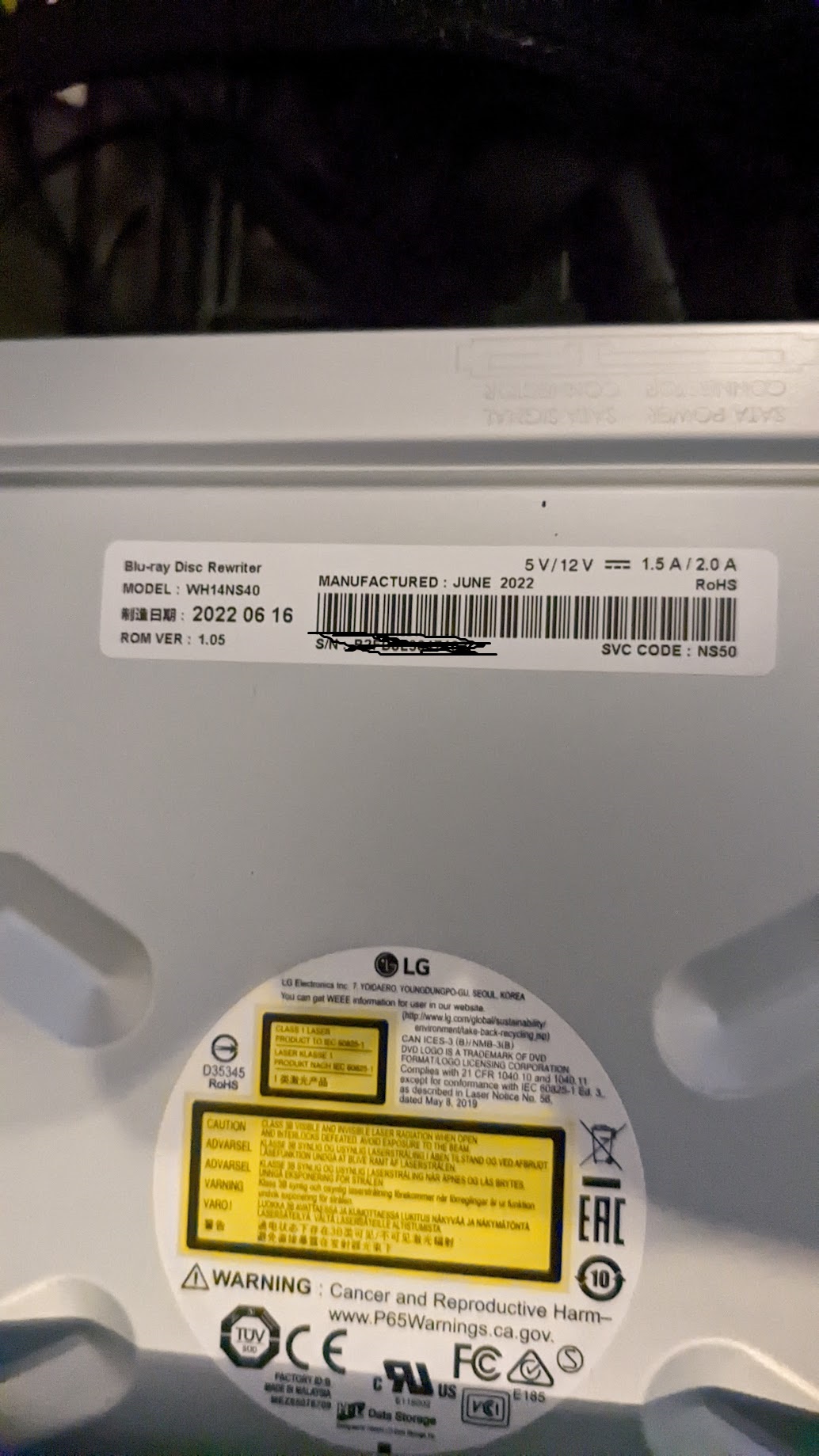

#1426 Post by onknight » Fri Nov 25, 2022 5:24 pm
Woodstock wrote: Fri Nov 25, 2022 3:16 pm Any drive from 2013 would NOT work for UHD, because it was built 2 years prior to UHD being defined.
It would work for DVD and BD, but you can buy new drives for that price that only does those.
I ended up rolling the dice on a new one and it looks like it paid off
so far it work on DVD and Blue rays I've ordered a Ultra Blu-ray to test tomorrow
I want to thank everyone for the great guides on doing this it's been very helpful
Screenshot_1 (Custom).png (79.61 KiB) Viewed 23467 times
WH14NS40 Blueray drive flash with WH16BS60 Ver 1.03
Linredrive Enabled

#1427 Post by onknight » Sat Nov 26, 2022 6:55 pm
SHould I update from 1.02 to Firmware version: 1.03 firmware ?
Linredrive Enabled

#1428 Post by onknight » Sat Nov 26, 2022 11:37 pm
Just an update was able to do the 4K UHD discs without any problem. Again thanks to everyone
Really looking forward to getting into this Hoppy
Linredrive Enabled
