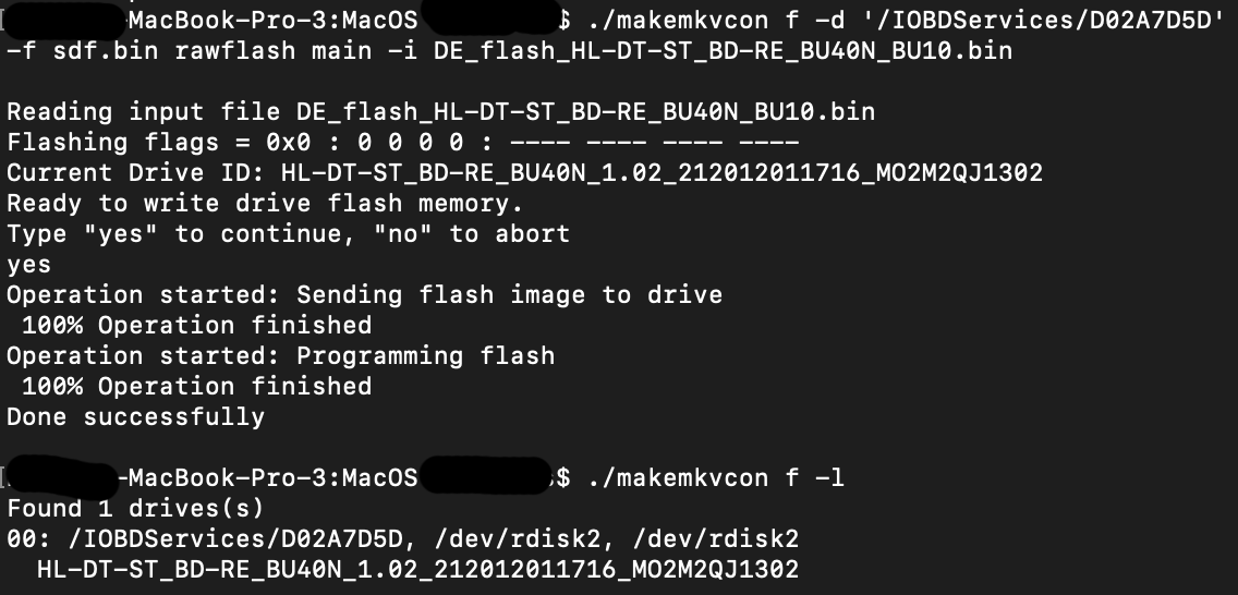

Hey folks. Finding it a little harder to do this on Mac OS as there doesn't seem to be as much info online.
I ran the following in the terminal, but it's saying that it's still 1.02 on my Archgon Drive (which is LG BU40N based).
Any ideas?
Any ideas?
- Posts: 6390
enc not main and dont use BU10 use 1.03mkrkrkrk wrote: Sat Nov 19, 2022 10:43 pm Hey folks. Finding it a little harder to do this on Mac OS as there doesn't seem to be as much info online.
Any ideas?
the guide says this all page 1

ThanksBillycar11 wrote: Sun Nov 20, 2022 12:26 amenc not main and dont use BU10 use 1.03mkrkrkrk wrote: Sat Nov 19, 2022 10:43 pm Hey folks. Finding it a little harder to do this on Mac OS as there doesn't seem to be as much info online.
Any ideas?
So I did the firmware upgrade to this file in the "All you need" firmware pack: HL-DT-ST-BD-RE_BU40N-1.03-NM00000-211810241934.bin
At that point, don't I then need to downgrade it to 1.00?
- Posts: 6390
no it can stay on 1.03 unless you need 1.00 for other rippersrkrkrk wrote: Mon Nov 21, 2022 1:02 am
