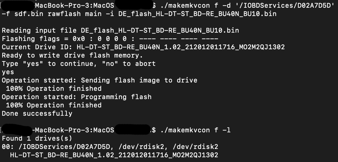

Hey folks. Finding it a little harder to do this on Mac OS as there doesn't seem to be as much info online.
I ran the following in the terminal, but it's saying that it's still 1.02 on my Archgon Drive (which is LG BU40N based).
Any ideas?
Posts: 6020
rkrkrk wrote: Sat Nov 19, 2022 10:43 pm Hey folks. Finding it a little harder to do this on Mac OS as there doesn't seem to be as much info online.
Any ideas?
enc not main and dont use BU10 use 1.03mk
the guide says this all page 1

So I did the firmware upgrade to this file in the "All you need" firmware pack: HL-DT-ST-BD-RE_BU40N-1.03-NM00000-211810241934.bin
At that point, don't I then need to downgrade it to 1.00?
Posts: 6020
rkrkrk wrote: Mon Nov 21, 2022 1:02 am
no it can stay on 1.03 unless you need 1.00 for other rippers
