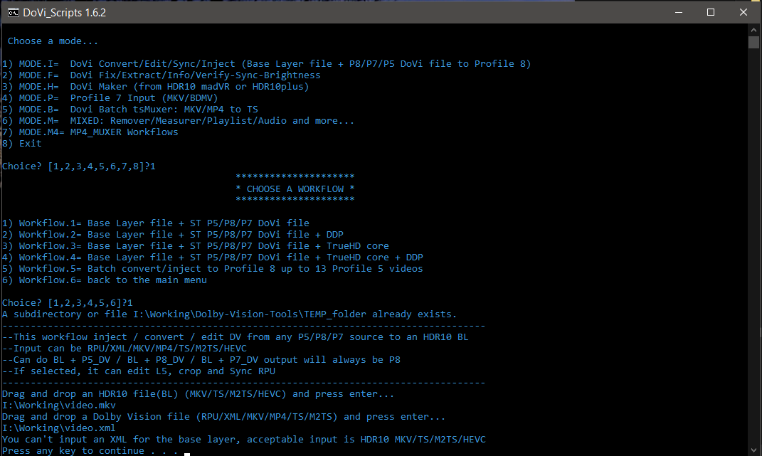

RESET_9999 wrote: Sat Oct 22, 2022 6:29 pm
Gatorman wrote: Fri Oct 21, 2022 11:08 pm I'm still working on getting the script to run correctly.
yes, it's not easy to install, I struggled myself.
you have to install python and a couple of modules.
https://www.python.org/downloads/
you can install a module(ijson in that case) by typing this in a cmd window
pip install ijson
Got it! Thanks for your help.
Screenshot (724).png (148.97 KiB) Viewed 17169 times
Gatorman
Posts: 84
Post by Gatorman »
@Reset_9999
Would it be possible to have a video.mkv.measurements file as an input file?
6-2-2 can do that.
Gatorman
Posts: 84
Post by Gatorman »
RESET_9999 wrote: Sat Oct 22, 2022 6:58 pm 6-2-2 can do that.
This workflow allows an already generated .measurements file? It's asking me for a video file. I'll have to get back to my workstation to get the error.
ha yes, I introduced a bug for that in the latest versions. you can try the older versions as 1.5.8, and it should work.
will fix next time

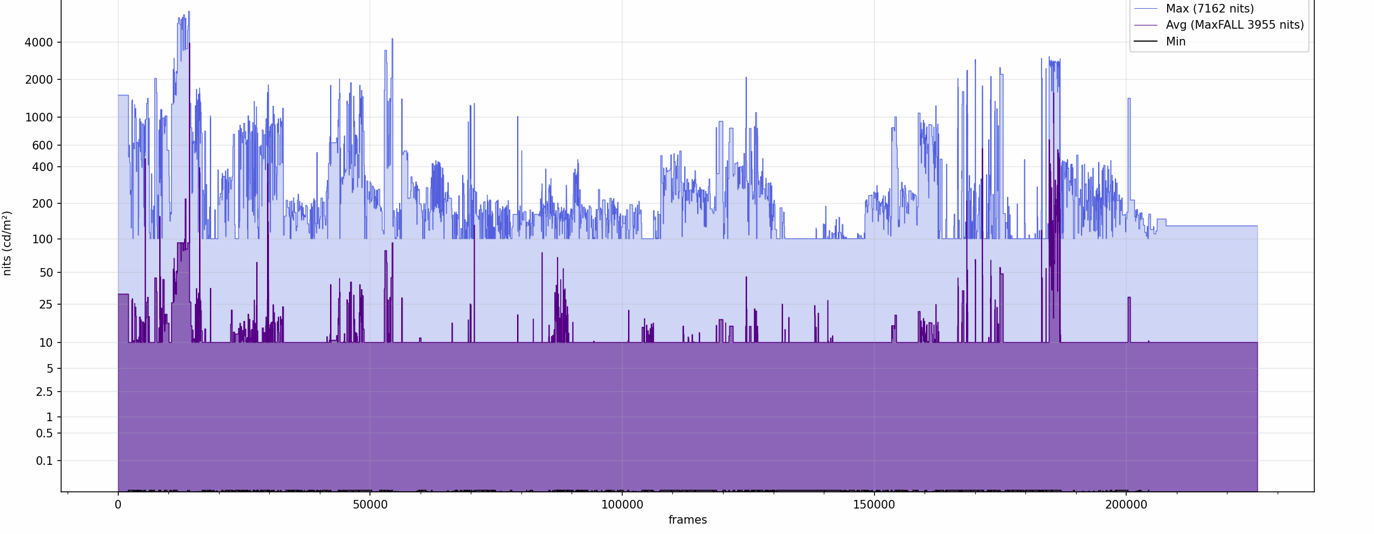

Does this comparison look typical? HDR10 Resolve generated DV.
https://slow.pics/c/fVBUu802
yes, as you can see madvr min_pq is always 0 which makes avg_PQ inaccurate.
Resolve's scene cut detection is also substantially better than madvr. With madVR, there will be (sometimes) one shot very bright and the next one(within the same scene) darker. I never had this issue with Resolve.

Post by Manixx2020beyound »
RESET_9999 wrote: Sun Oct 23, 2022 2:53 pm yes, as you can see madvr min_pq is always 0 which makes avg_PQ inaccurate.
I’ve come to the conclusion that if we re analyze a movie that’s already graded scene by scene technically we are producing a diff graded result as well.(bc color decisions are being decided by present graded elements)
& that’s why they are diff types of analysis modes some of us have only experienced 1type of analysis mode.
100% non-sense.
L1 metadata generation is just pixels brightness measurement(this is what the dovi L1 plot is). When you set your resolve project correctly you don't touch the original grade. it's like working with the master.
You could export it to 422 and then re-encode it to x265 and it would still be the same grade(unless you start playing with the colors and brightness).
RESET_9999 wrote: Sun Oct 23, 2022 9:42 pm 100% non-sense.
The meta data results are close but never identical facts.
To get identical, a 12bit true master is necessary,
Also that’s like saying the 8.1 dv/hdr resolve produces is NOT an official 8.1?
Our experience with 8.1 only came about with xml/rpu (quietvoid)
