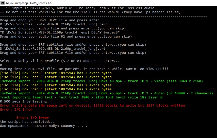

Hi Guys!
Could someone pls tell me what i do wrong when trying to "repack" mkv p8 to mp4 p8 using RESET_9999's DoVi scripts?
I got smth like this
looks like it's trying to convert lossless audio to EAC3 but your file doesnt have lossless audio. I'll have a look.
right now you could just demux your file with mkvextract and then use workflow 1 and input HEVC + EAC3 + SRT
Have tried as recommended. Dropped extracted hevc and used workflow 1.
It says smth about "no space" but demuxed files are 9Gb and i have 18Gb free space left on the HDD.
