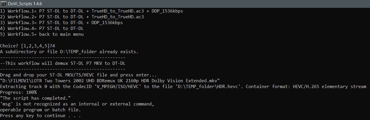

Thanks! I went through the lengthy process but got an error at the end. Any suggestions?

Amused wrote: Fri Jul 29, 2022 7:52 am Thanks! I went through the lengthy process but got an error at the end. Any suggestions?
thats just "the script has completed" popup msg that didnt work. you can ignore that.
