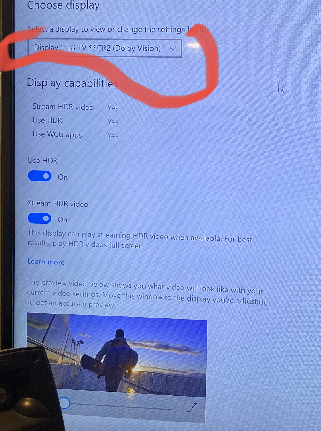

Monitor need to be seen as this
RESET_9999 wrote: Sun Jul 17, 2022 3:20 pm
Manixx2020beyound wrote: Sun Jul 17, 2022 2:59 pm I use a dv tv as monitor & widows app this is the playback I get from windows app
This is probably as close to dv on a pc with mp4, pc is in hdr mode when dv kicks in.
https://drive.google.com/file/d/1bEHAjx ... p=drivesdk
you forgot to mention that you have to use the Vertex to trick windows into thinking you have a DV monitor. :)
True lol

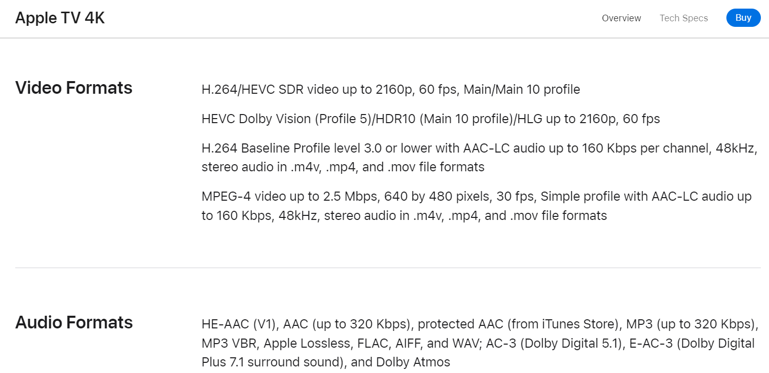

RESET_9999 wrote: Sun Jul 17, 2022 12:24 pm FYI, @ragico tested, LPCM, DTSHD, and TrueHD in a dvh1 MP4 container and the ATV fails the play the audio.
So the best we can get is EAC3 1536kbps.
That is strange, Apple says it can play them.
The attachment 无标题.png is no longer available
TrueHD and DTS shouldn't work.
LPCM(7.1), flac(7.1), alac(6.1) all work fine on my iPad. But it would be impossible to tell if they are true loseless through the built-in speaker, lol.
I have some samples produced through my usually workflow. These could probably be the highest standards video on iOS devices for now. Feel free to test them:

RESET_9999 wrote: Sun Jul 17, 2022 3:23 pm actually, if you turn HDR on in the windows display settings, you get HDR10 output with the RPU being used for the Windows app. Works with MP4 only.
"with the RPU being used", like software decoding DV and lldv? or HDR10+? or just plain HDR10?
Samsung refuses to support DV.
RPU effects are displayed in the Windows apps.
Has to be a Microsoft store app, not Win32 app and you need the Dolby Vision Extensions app from the store installed to make it work in store apps. Works with Microsoft Movies & TV app and new Media Player store app. Worked in the old Plex store app too but it's broken with collections introduction so not worth it IMO there for Plex. Has to be MP4 as stated.
It's how I verify any RPU misalignments myself when making the DV files on a Win10/11 computer for a while now.
Used to be able to watch too if you didn't care about pq inaccuracies but there's a bug lately on my end with Win 11 at least across reinstalls, DV file will cause video orientation to constantly switch upside down back again upside down again etc.
Playback/player probably tripping up parsing the Metadata, it's only on DV files it happens. Or they did something intentional to make you need more than we had so you go buy a licenced DV PC.
I just use my computer just to verify anyway like I said as my monitor has no local dimming so after 30 mins in HDR my eyes are bleeding anyway, oh well.
sw5163 wrote: Sun Jul 17, 2022 8:47 pm
it works just like LLDV but in HDR10 PQ with brightness ajdustments ...
see DV P8:
https://www.youtube.com/watch?v=lQFjyBm7ToA

RESET_9999 wrote: Sun Jul 17, 2022 10:35 pm Also, as @manix just showed, you don't need a DV-certified pc/monitor to get DV on windows. Just a DV TV, a vertex and an HDR10 capable pc.
Does it have to be a DV tv? What will happen for something like Samsung QD-OLED directly connects to PC without vertex? Only plain HDR10?
RESET_9999 wrote: Sun Jul 17, 2022 10:35 pm he's talking about the fact that the movies&TV app (windows HDR10) is not color accurate (regardless of DV). At least it wasn't the last time i checked(months ago). I should probably check that again.
i just dont really care about HDR10 anymore.
Thank you so much for the clarification!
sw5163 wrote: Sun Jul 17, 2022 10:55 pm Does it have to be a DV tv? What will happen for something like Samsung QD-OLED directly connects to PC without vertex? Only plain HDR10?
works on any HDR10/SDR display. The pc just needs what @staknhalo listed.
It seems loseless + atmos is possible on Apple device as they did it in Apple Music.
I guess they use alac+atmos.
Is there a public way to convert trueHD/atmos to "loseless 7.1 PCM atmos" as Dolby MAT 2.0?
I would say the limitation for ATV is MEL + loseless 7.1 atmos.
We just don't know how to get the loseless atmos yet.
