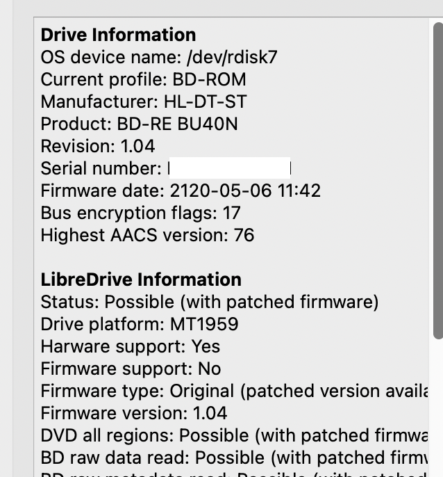

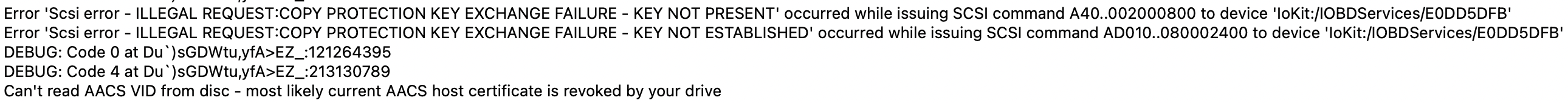

Dear all
hope that somebody can help me.
I mean that my drive is a LG BU40N
I've tried to flash him via MAC OS
All has worked as described, but I'm still not allowed to copy UHD disks
Thanks a lot for any help

- Posts: 6007
Your drive is not flashed be sure to use encJeannozt wrote: Wed Jun 29, 2022 12:05 pm Dear all
Hello what do you mean with use encBillycar11 wrote: Wed Jun 29, 2022 1:12 pmYour drive is not flashed be sure to use encJeannozt wrote: Wed Jun 29, 2022 12:05 pm Dear all

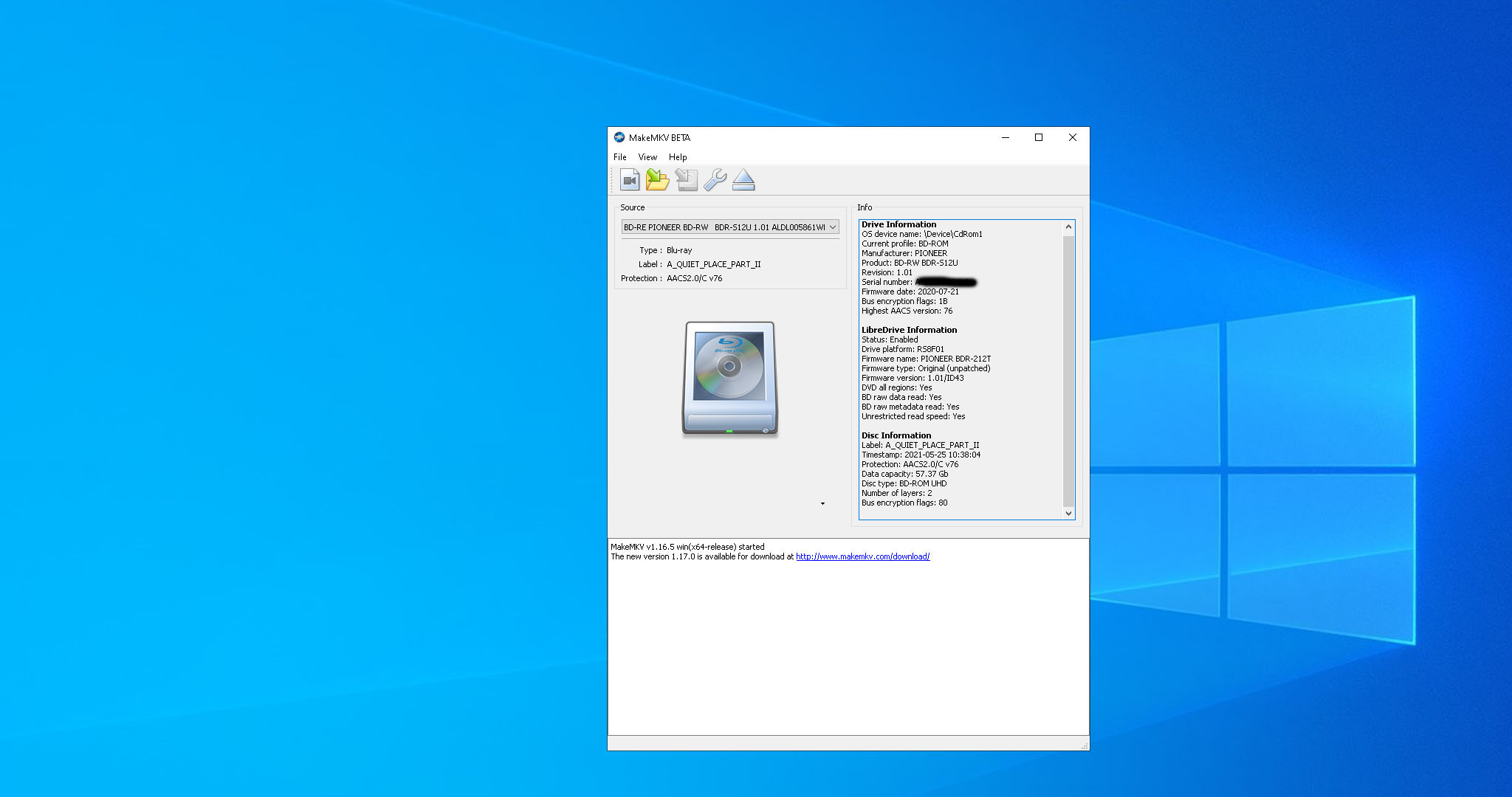

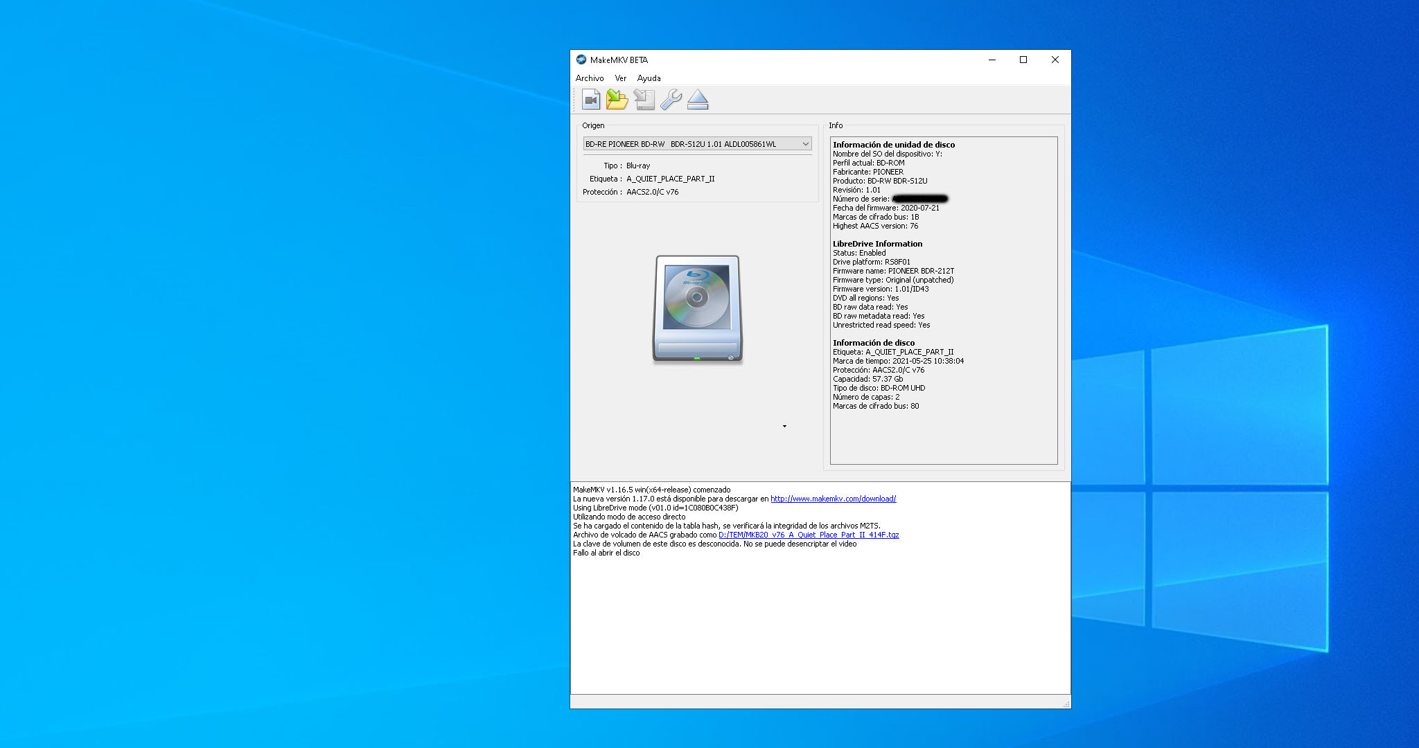

Chatomarocoloco
- Posts: 4
- Joined: Wed Jun 29, 2022 2:37 pm
I have the Pioneer BDR-S12UHT recorder and player. Read original UHD blu-ray but could not play due to processor issue.
The problem is that I want to remove the anti copy with MakeMKV and I get the error shown in the image. Is this model compatible?
or the error is due to something else that I do not know.
a greeting.
a greeting.
