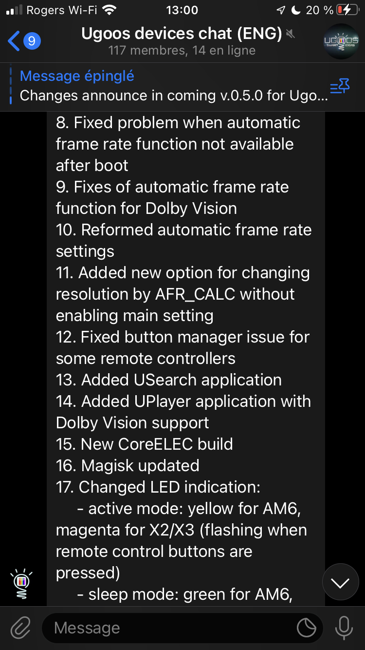

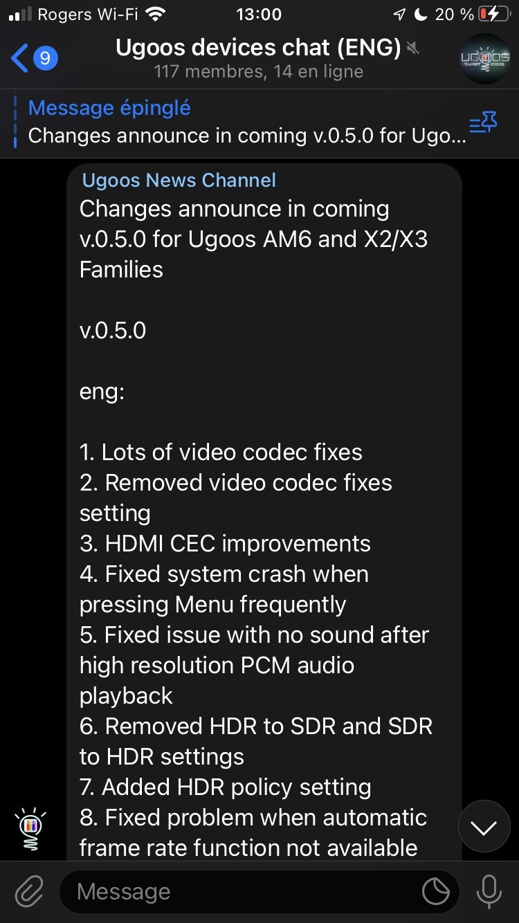

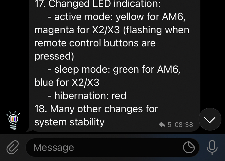

Mattl0 wrote: Sat Apr 23, 2022 5:04 pm Anyone tried the 5.0 fw from Ugoos on am6 b? Wonder how’s the dv playback. I will test it when I have time (currently the unit is somewhere, need to find it lol) .
F9220A1F-B95D-4B07-83FB-19CFD5159257.pngC8E9B873-8502-4BDF-B4FD-3602ACEBADDC.pngA594274E-B3FB-4A57-91F1-051FBD0A3621.jpeg
Do you know where I can download the firmware from?

mattmarsden wrote: Mon Apr 25, 2022 12:57 pm
Sorry , no, that was only a news from Ugoos . It it not out yet
