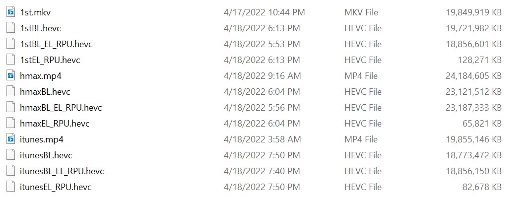

Hey whats up @RESET_9999
I've been lurking on here for a while now. I'm pretty much a novice to DV ripping/encoding stuff... With Yusesope's and your help I recently was successful in ripping my first DV movie (.m2ts file) file to DV profile 8 mp4. (So, that I can watch on my LG CX). Thanks!
Since then, Ive been examining a bunch different random DV movies and shows.
So, right before I saw this post, I myself noticed the different sizes of EL/RPU data. I've attached a screenshot of my file sizes. The 1st DV source that was leaked last night had an even larger sized EL/RPU data than the iTunes version. I'm not quite sure where that source came from though. You put down "iTunes, HBOmax, and MA" as the 3 sources you have. Forgive, my ignorance... but what source is "MA"?
Also, what do you make of HBOmax version being a few gigabytes larger in size? What do you make of that? Would that be the best version to watch?
I've attached a screenshot to show you what I got.
If anything that I'm saying is wrong or sound funny please dont hesitate to correct me
- layersizes.jpg (93.79 KiB) Viewed 20866 times
