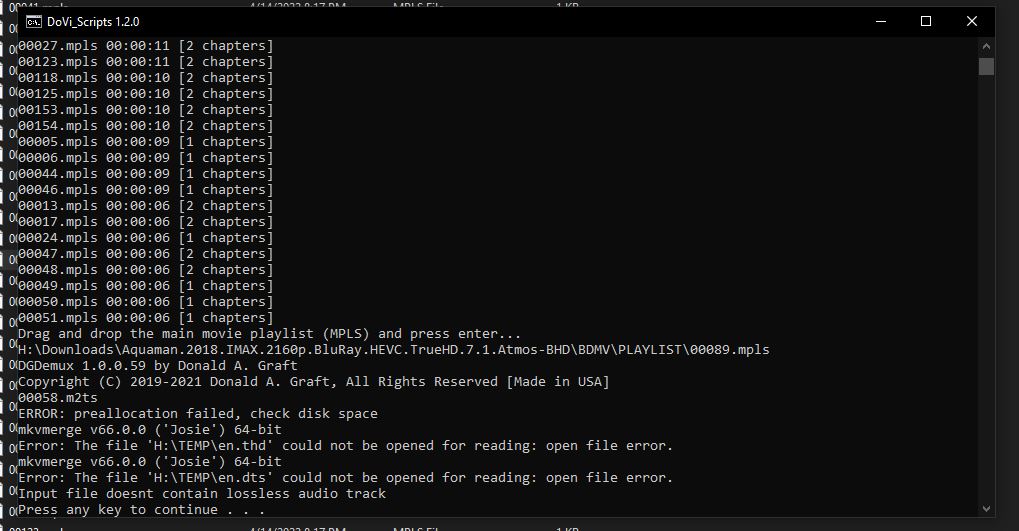

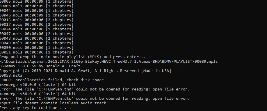

Thank you for the Reply i did Try that but i got an error here is an Img ( there is plenty of space)
redoine322 wrote: Sat Apr 16, 2022 2:54 pm i did Try that but i got an error here is an Img ( there is plenty of space)
yeah DGdemux wont work if you place the folder on your C:\ drive... do you have another drive you can put the folder on?
redoine322
Joined: Fri Apr 15, 2022 2:16 am
Post by redoine322 »
RESET_9999 wrote: Sat Apr 16, 2022 10:05 pm
Same Problem i did try it on two different drives
redoine322 wrote: Sat Apr 16, 2022 10:24 pm
try 1.2.1, it should work.

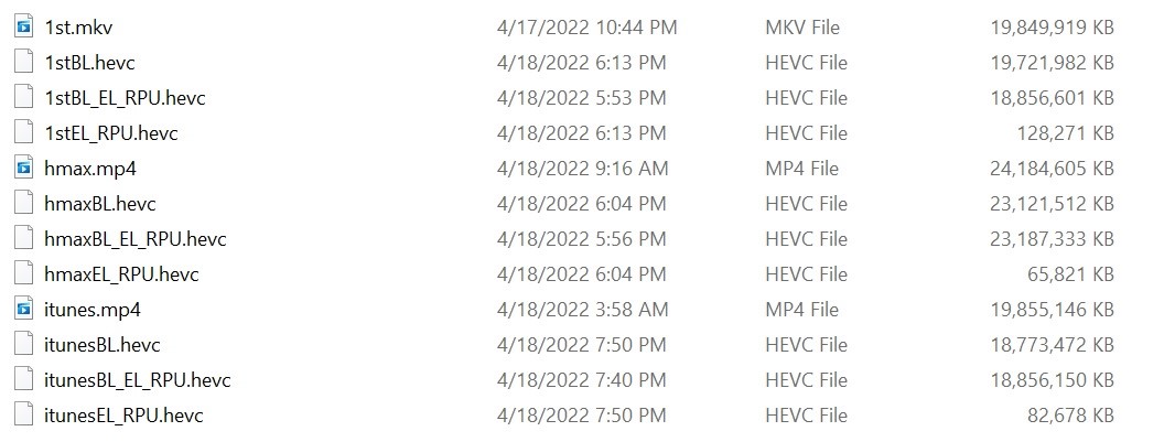

Hi guys, Im kinda new to all this so here it goes:
I have some 4K files in p07 that I would love to convert to p8.1 or p5. I saw several messages here but Im kinda lost with this coding and muxes. I was able to instal ffmpeg in my mac (m1) but now i dont know what to do to convert a file. do i need to install anything else? Is there a tutorial for this?
I took a look at the Dolby Vision metadata of The Batman itunes/movies anywhere/HBO and the differences are quite surprising. Itunes RPU is much larger even without L5 and L4. @Quietvoid, any idea why?
Also, why the hell are they all using the old Dolby vision algorithm CMV2.9... CMV4.0 is supposed to be superior, especially for the SDR trim passes. They can do the grade in 4.0 and then export in 2.9 for compatibility reasons though. Another interesting fact about HBO and MA, the colors are not the same(at least for HDR10) but they have the same L1/L2 DV metadata. https://slow.pics/c/axsHELui
