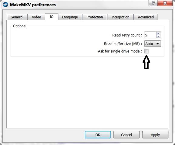

Have you tried 'single drive' mode'?

I use single drive mode all the time and have successfully ripped 3 discs at high speed at the same time.

d00zah wrote: Fri Apr 15, 2022 10:54 pm Have you tried 'single drive' mode'?
Thank you so much :D , I never noticed this option. Hahaha I just made a big joke.

dcoke22 wrote: Sat Apr 16, 2022 12:20 am I use single drive mode all the time and have successfully ripped 3 discs at high speed at the same time.
thanks, single drive mode does work :D
