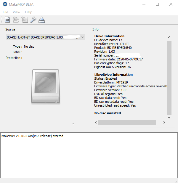

What do I do next to make it so I can rip UHD? This is my first time doing something like this
- Posts: 10972
Re: Help with BP50NB40 for UHD
MakeMKV says it is as ready as it's going to be.

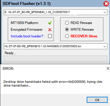

Okay I found a version from the "The all you need firmware pack" but it gives me an errorMartyMcNuts wrote: Tue Feb 08, 2022 4:56 amYou cannot rip UHD using BP50NB40 firmware. It is not capable. You now need to cross-flash it to BP60NB10 1.00-MK firmware.FatNFuri0us1 wrote: Tue Feb 08, 2022 12:58 am What do I do next to make it so I can rip UHD? This is my first time doing something like this

I said BP60NB10 1.00-MK, not 1.02-MK.FatNFuri0us1 wrote: Tue Feb 08, 2022 9:56 pmOkay I found a version from the "The all you need firmware pack" but it gives me an errorMartyMcNuts wrote: Tue Feb 08, 2022 4:56 amYou cannot rip UHD using BP50NB40 firmware. It is not capable. You now need to cross-flash it to BP60NB10 1.00-MK firmware.FatNFuri0us1 wrote: Tue Feb 08, 2022 12:58 am What do I do next to make it so I can rip UHD? This is my first time doing something like this
Anyway, when you press OK on the handshke message does it work?
Is your drive SVC NB40, NB50 or NB52?

Okay so I found the 1.00 version and it did the same thing. When I press okay it flashes something but nothing changes. NB52MartyMcNuts wrote: Tue Feb 08, 2022 11:08 pmI said BP60NB10 1.00-MK, not 1.02-MK.FatNFuri0us1 wrote: Tue Feb 08, 2022 9:56 pmOkay I found a version from the "The all you need firmware pack" but it gives me an errorMartyMcNuts wrote: Tue Feb 08, 2022 4:56 am

Whenever I try anything it just gives me the same errorMartyMcNuts wrote: Wed Feb 09, 2022 2:52 amNB52 is the issue. It can be done just a slightly different way.FatNFuri0us1 wrote: Tue Feb 08, 2022 11:37 pmOkay so I found the 1.00 version and it did the same thing. When I press okay it flashes something but nothing changes. NB52MartyMcNuts wrote: Tue Feb 08, 2022 11:08 pm

It's just the same error again. “Desktop drive handshake failed with error=0x82000000, trying slim drive handshake...”MartyMcNuts wrote: Wed Feb 09, 2022 9:58 pm @Astrogoth64, @FatNFuri0us1,
