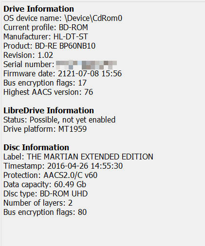

I have a new LG BP60NB10 UHD drive. I tried flashing it with sdftool_flasher, but MakeMKV still won't read UHD disks
Product: BD-RE BP60NB10
Revision: 1.02
Serial number:
Firmware date: 2121-07-08 15:56
Highest AACS version: 76
Disc Information
Label: THE MARTIAN EXTENDED EDITION
Timestamp: 2016-04-26 14:55:30
Protection: AACS2.0/C v60
Data capacity: 60.49 Gb
Disc type: BD-ROM UHD
Number of layers: 2
Bus encryption flags: 80
I .bim I used to flash:
HL-DT-ST-BD-RE_BP60NB10-1.02-NM00800-212005070935.bin
Errors MakeMKV is throwing:
Error 'Scsi error - ILLEGAL REQUEST:COPY PROTECTION KEY EXCHANGE FAILURE - KEY NOT PRESENT' occurred while issuing SCSI command A40..0020..0FF to device 'SPTI:\Device\CdRom0'
Error 'Scsi error - ILLEGAL REQUEST:COPY PROTECTION KEY EXCHANGE FAILURE - KEY NOT PRESENT' occurred while issuing SCSI command A40..002000800 to device 'SPTI:\Device\CdRom0'
Error 'Scsi error - ILLEGAL REQUEST:COPY PROTECTION KEY EXCHANGE FAILURE - KEY NOT ESTABLISHED' occurred while issuing SCSI command AD010..080002400 to device 'SPTI:\Device\CdRom0'
Saved AACS dump file as C:\Users\nican/.MakeMKV/MKB20_v61_The_Last_Jedi_3357.tgz
Failed to open disc
Any ideas?

- Posts: 5063
It doesn't look like you have flashed it yet. When it has successfully flashed, in MakeMKV you will see:Bruin wrote: Mon Jan 17, 2022 1:13 am I have a new LG BP60NB10 UHD drive. I tried flashing it with sdftool_flasher, but MakeMKV still won't read UHD disks

- Posts: 6176
yup not flashed probably did not use encMartyMcNuts wrote: Mon Jan 17, 2022 2:15 amIt doesn't look like you have flashed it yet. When it has successfully flashed, in MakeMKV you will see:Bruin wrote: Mon Jan 17, 2022 1:13 am

I did flash it once and it seemed as though it had flashed the drive (I don't believe I had the enc box checked). However, when I try to run sdftool_flasher now I get the following error:

First, thanks for the reply. You were correct that it had not been flashed. However, the reason I was getting an error from sdftool_flasher was because I had a DVD in the drive. Once I removed the DVD I was able to flash the drive and MakeMKV is now working. I am able to copy UHD disks. Thanks again.
