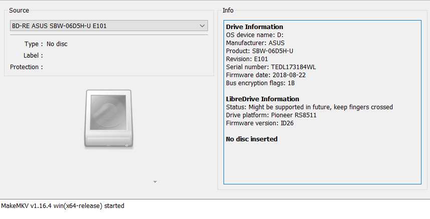

If you already have the drive, open MakeMKV with it connected, and MakeMKV will tell you if it is or can be UHD-capable. There is precedent for Asus putting different drives in the same model enclosure, and you cannot tell by the model number. When MakeMKV queries the drive hardware, though, the truth comes out.

This is the info shown in MakeMKV. Just let me know if I have to launch some other tool or look for something else.
Manufacturer: ASUS
Product: SBW-06D5H-U
Revision: E101
Serial number: TEDL173184WL
Firmware date: 2018-08-22
Status: Might be supported in future, keep fingers crossed
Firmware version: ID26
Manufacturer: ASUS
Revision: E101

The fact that the drive is a Pioneer says you're not going to be able to use it for ripping UHD disks yet.
However, it MAY be an "official" UHD drive, that can be used with PowerDVD to play UHD disks, but being built in 2018 makes that a slim possibility. Personally, I wouldn't buy PowerDVD to find out; it is a better long-term solution to get a UHD-friendly drive, if UHD is important to you.

Ok thanks for the answer. And what about what @Blackened2687 wrote about flashing this drive with a "BDR-UD03 or BDR-UD04" firmware?

Still won't help you with UHD.Mag1ster wrote: Wed Sep 15, 2021 7:37 am Ok thanks for the answer. And what about what @Blackened2687 wrote about flashing this drive with a "BDR-UD03 or BDR-UD04" firmware?

Apologies for resurrecting an old thread, but I'm curious:MartyMcNuts wrote: Wed Sep 15, 2021 8:39 amStill won't help you with UHD.Mag1ster wrote: Wed Sep 15, 2021 7:37 am Ok thanks for the answer. And what about what @Blackened2687 wrote about flashing this drive with a "BDR-UD03 or BDR-UD04" firmware?
Could anybody elaborate on why this would not help with UHD? If I understand correctly the BDR-UD04 is UHD capable, it is listed among the recommended Pioneer drives in the ultimate flashing guide...
Or does this refer to the fact that before 2022 Pioneer drives were not supported generally?

Exactly. Comment was made well before support was added.astrea wrote: Tue Jan 10, 2023 3:03 pmApologies for resurrecting an old thread, but I'm curious:MartyMcNuts wrote: Wed Sep 15, 2021 8:39 amStill won't help you with UHD.Mag1ster wrote: Wed Sep 15, 2021 7:37 am Ok thanks for the answer. And what about what @Blackened2687 wrote about flashing this drive with a "BDR-UD03 or BDR-UD04" firmware?
