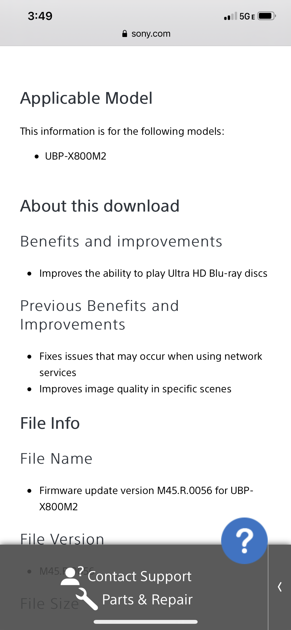

Post by Manixx2020beyound »
Any sony x700 & Sony 800m2 users
Updated their firmware:
And if so any noticeable differences
Came out on the 8/24/21
Nitflix,vudu & uhd disc doblyvision
Wondering if they fixed anything DV related.

Manixx2020beyound wrote: Tue Sep 07, 2021 7:59 pm Any sony x700 & Sony 800m2 users
This is from Sony's website Sony X700 owners:
Firmware update version M43.R.0284 for UBP-X700 | Release Dat 08-24-2021
  • Removes the Gracenote function
    Improves HDMI connection stability
    Supporting Dolby Vision content for Blu-ray Disc, Netflix and VUDU
    Supporting online streaming services
Have not updated mine yet. Whatever DV support means in the text above. Maybe they fixed the DV limitation where you had to know which movie/disk is DV to manually enable it?
mulucy wrote: Wed Sep 08, 2021 2:09 pm
Yea but nitflix & vudu as well so it might be more than just movie/disk is dv,
Well only 1 way to know,
I updated mines a week ago but haven’t look closely at any changes.
