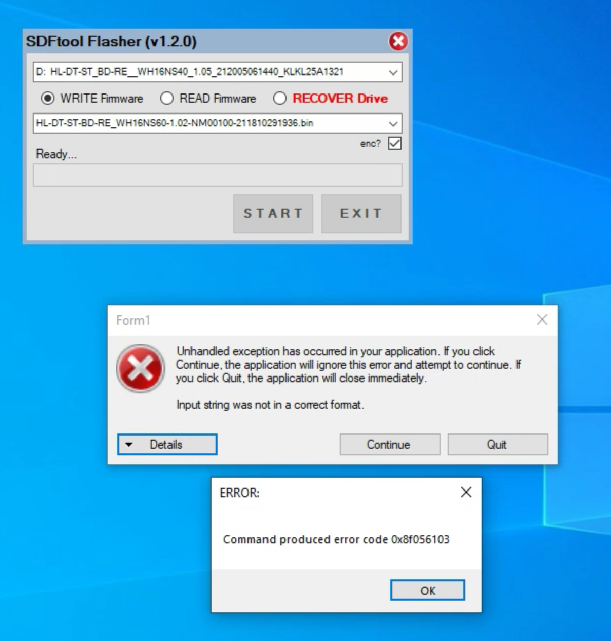

Got a brand new WH16NS40 with 1.05 Firmware.
SDFTool v1.2.0, trying to flash to WH16NS60 v1.02 from the old folder, check the enc box.
Getting error code 0x8f056103
On Windows 10 X64. dotNet newer then 4.7.2
What am I doing wrong?

- Screen Shot 2021-08-20 at 9.38.39 AM.png (876.77 KiB) Viewed 36431 times

First flash 1.05 MK with enc. Then downgrade to whatever you want.
After that don't check enc anymore.

that should have worked try the command line.SteelBookCollector wrote: Fri Aug 20, 2021 1:47 pm Got a brand new WH16NS40 with 1.05 Firmware.
- Posts: 4985
Re: SDFtool Flasher
How is your drive connected?SteelBookCollector wrote: Fri Aug 20, 2021 1:47 pm Got a brand new WH16NS40 with 1.05 Firmware.
Do you have MakeMKV 1.15.1 or above instlled?
