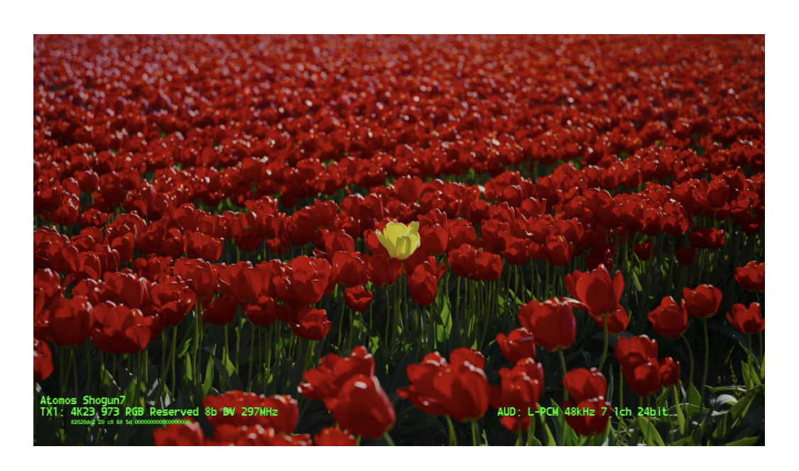

Well some comparison news:
We can now compare RGB 8bit DV so we don’t need to do (LLDV/bug,)
Still a few more tests to come.
Bypassing the pink screen in rgb 8 dv
This clip is from the x700.
