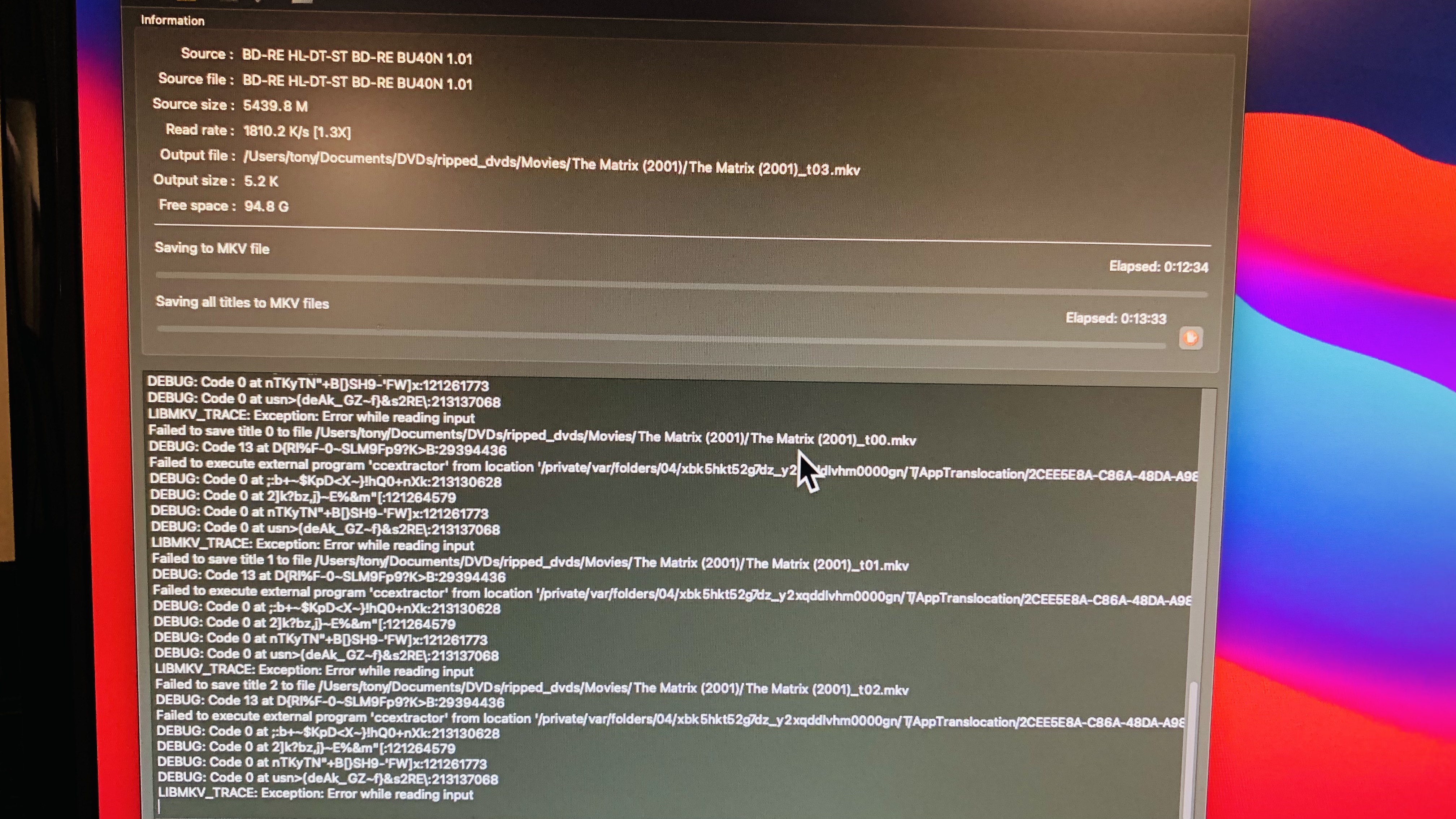

I've recently installed 1.16.0, but didn't test it until now.
I popped in The Matrix DVD and tried to rip it on an M1 Macmini.
MakeMKV started out ok, but then quickly had problems.
MakeMKV thinks the output file is 5.2KB, and just stops writing to disk.

1.16.0 is definitely broken.
I''ve tried ripping 2 different DVDs using 1.16.0, nothing but errors.
I then tried ripping the same DVD with MDRP, I had no problems whatsoever.

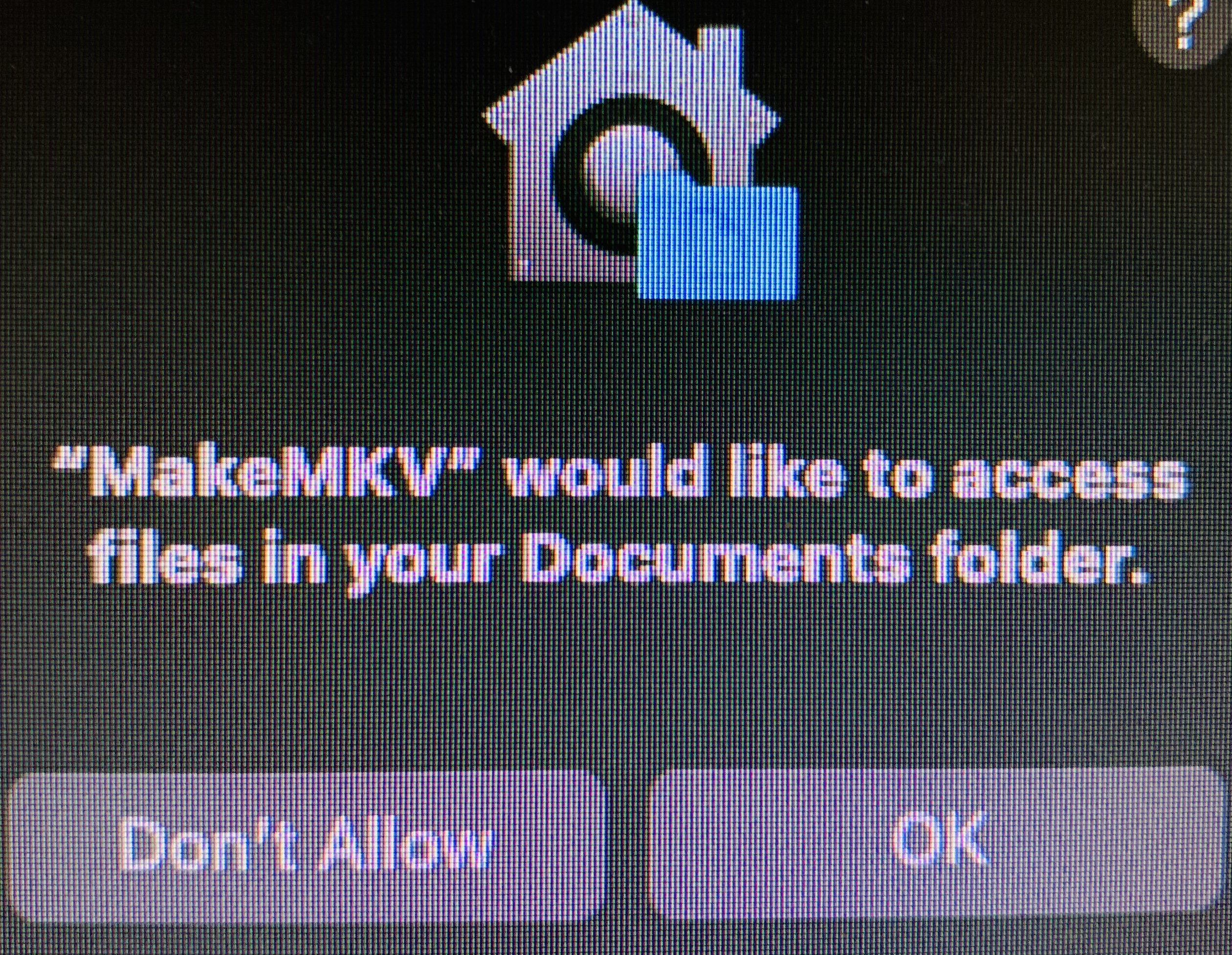

1.16.0 keeps asking me for access to one of my Documents folder, every time I launch it.

What happens if you change the permission on mmccextr in the App bundle?
https://www.makemkv.com/forum/viewtopic.php?f=4&t=24651
I think the 'Failed to execute external program 'ccextractor' …' message is because of incorrect permissions in 1.16.0.

What permissions should I change it to?

You need to do a chmod +x on it, to make it executable.
Previous versions included the eXecute bit being set already.

Ok, done. Ripping again.Woodstock wrote: Thu Mar 04, 2021 3:50 pm You need to do a chmod +x on it, to make it executable.

My M1 Mac does not show a prompt when I launch MakeMKV. Can you take a screenshot of it (https://support.apple.com/en-us/HT201361) and post it here? Also, what do you answer for this prompt?

They aren't addressing the issues I've been reporting. Well, they fixed the permissions issue,
but MakeMKV still prompts me for access to my Documents folder, and the two checkboxes are still disabled.

MakeMKV does not ask any permissions, this is done by OS. I would like what kind of folder the program tries to access, could be a Data directory misconfiguration.cappy2112 wrote: Thu Mar 04, 2021 11:37 pm but MakeMKV still prompts me for access to my Documents folder, and the two checkboxes are still disabled.

mike admin wrote: Thu Mar 04, 2021 11:44 pmMakeMKV does not ask any permissions, this is done by OS.cappy2112 wrote: Thu Mar 04, 2021 11:37 pm but MakeMKV still prompts me for access to my Documents folder, and the two checkboxes are still disabled.
The picture below makes the user think MakeMKV is prompting the user. This did not happen prior to 1.16.x

In macOS Big Sur the folders Desktop, Downloads, and Documents have extra security permissions.
https://support.apple.com/guide/mac-hel ... a35146/mac
Are you trying save rips to your Documents folder? Or is the MakeMKV data directory (in MakeMKV's preferences) set to Documents? Or maybe the log is trying to go into Documents? On my system, a MBA, in System Preferences -> Security & Privacy -> Privacy -> Files and Folders, MakeMKV only has permission to access Removable Volumes. I don't put rips or anything into any of the protected folders.
