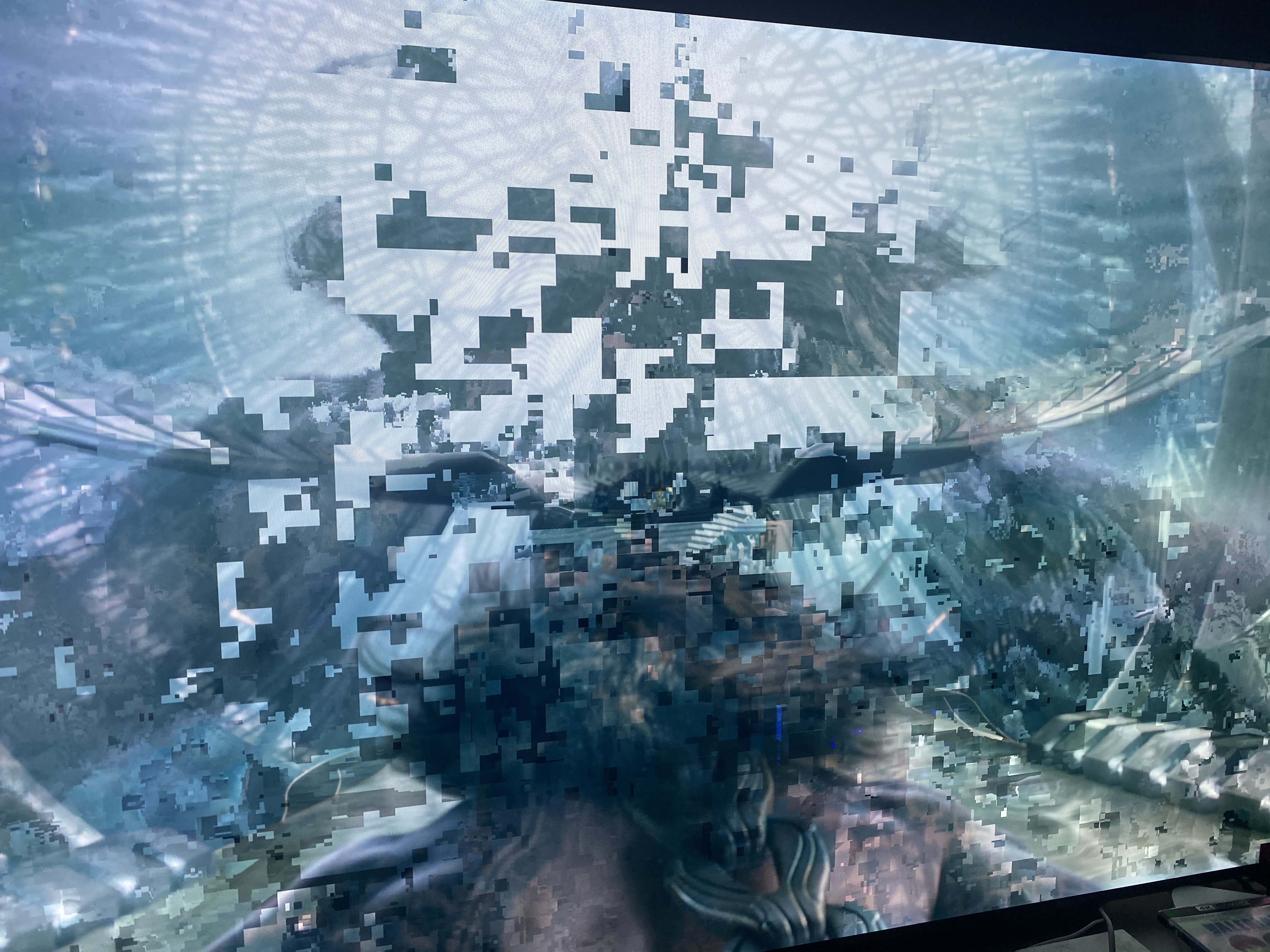

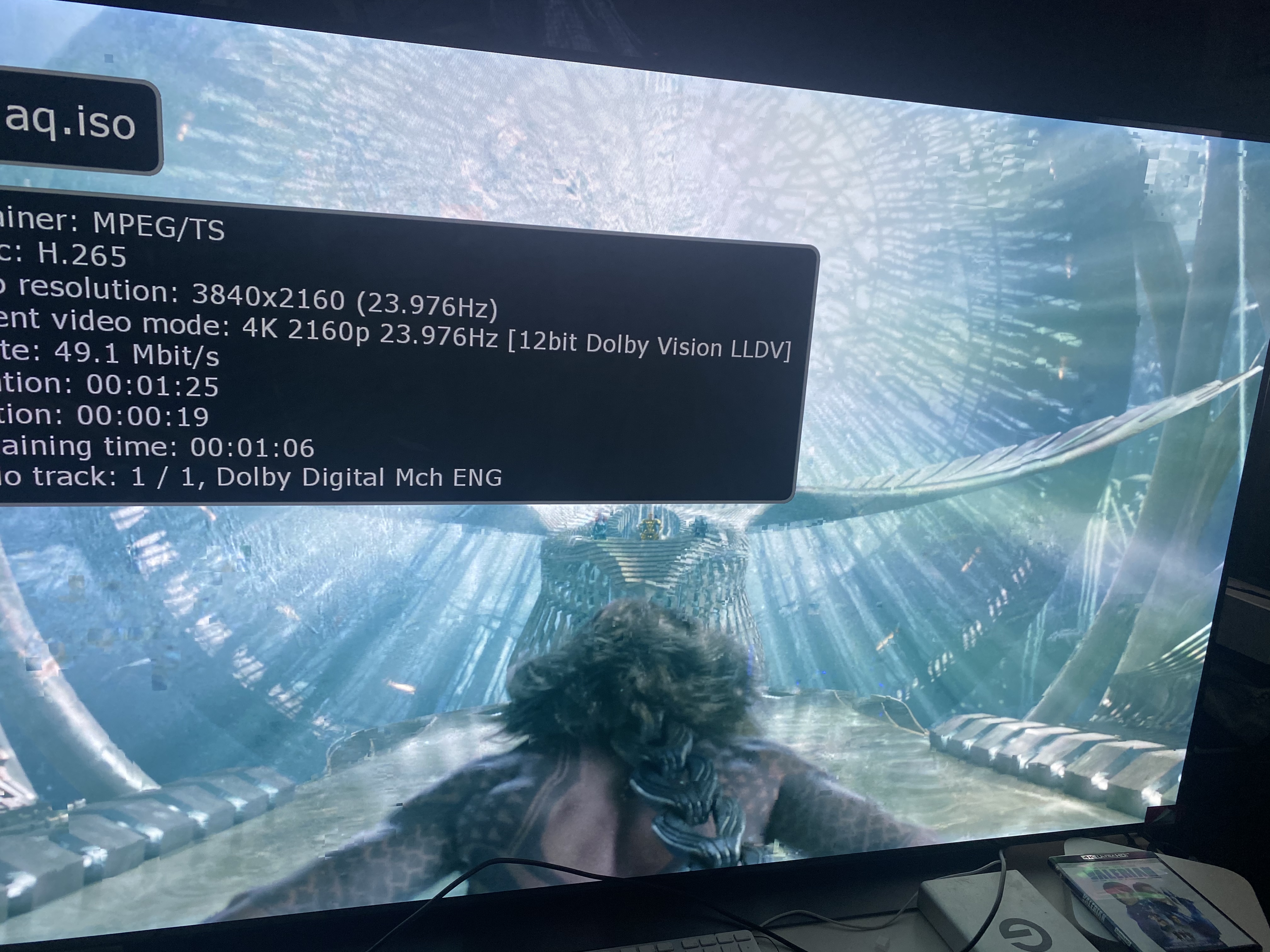

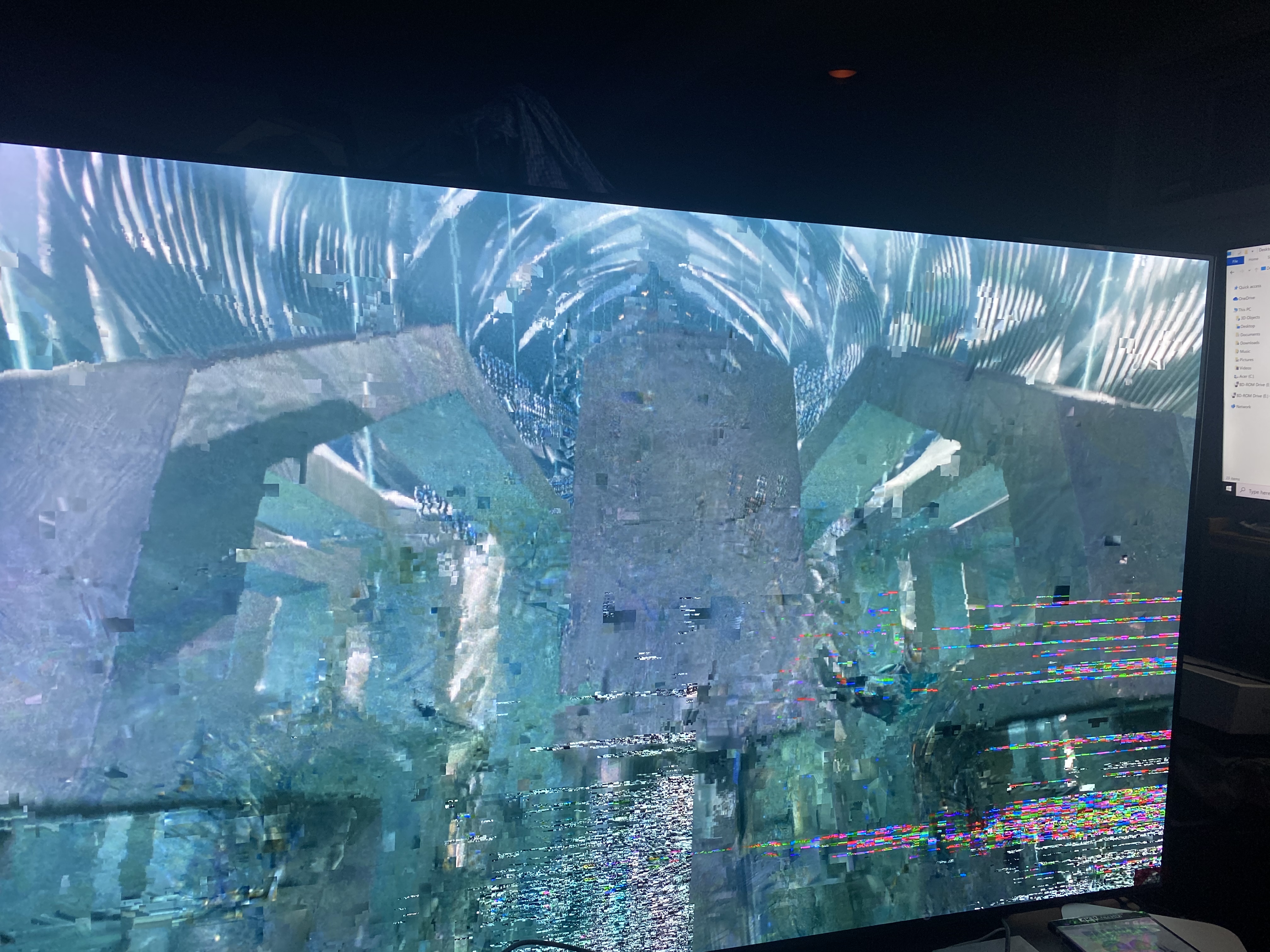

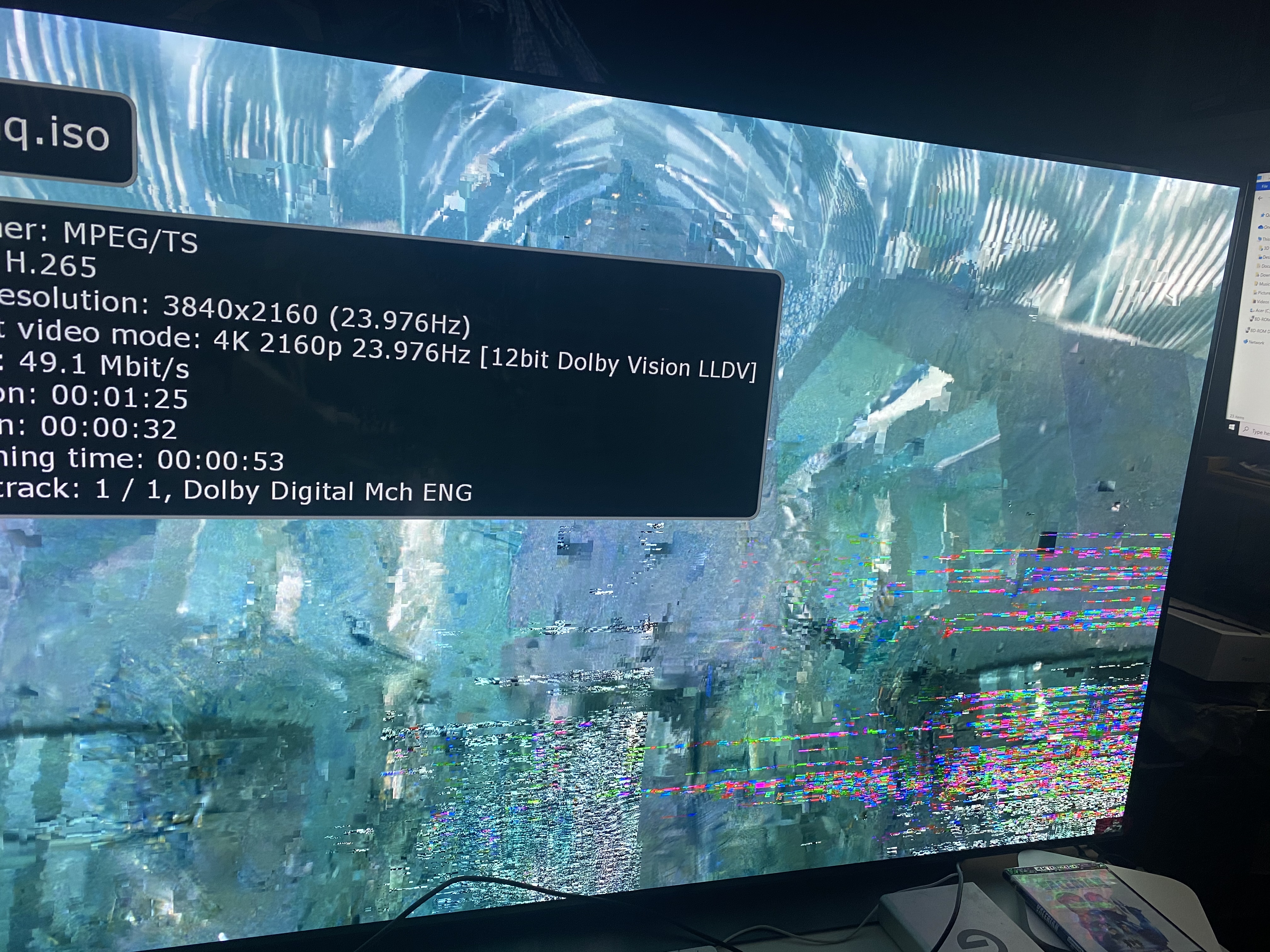

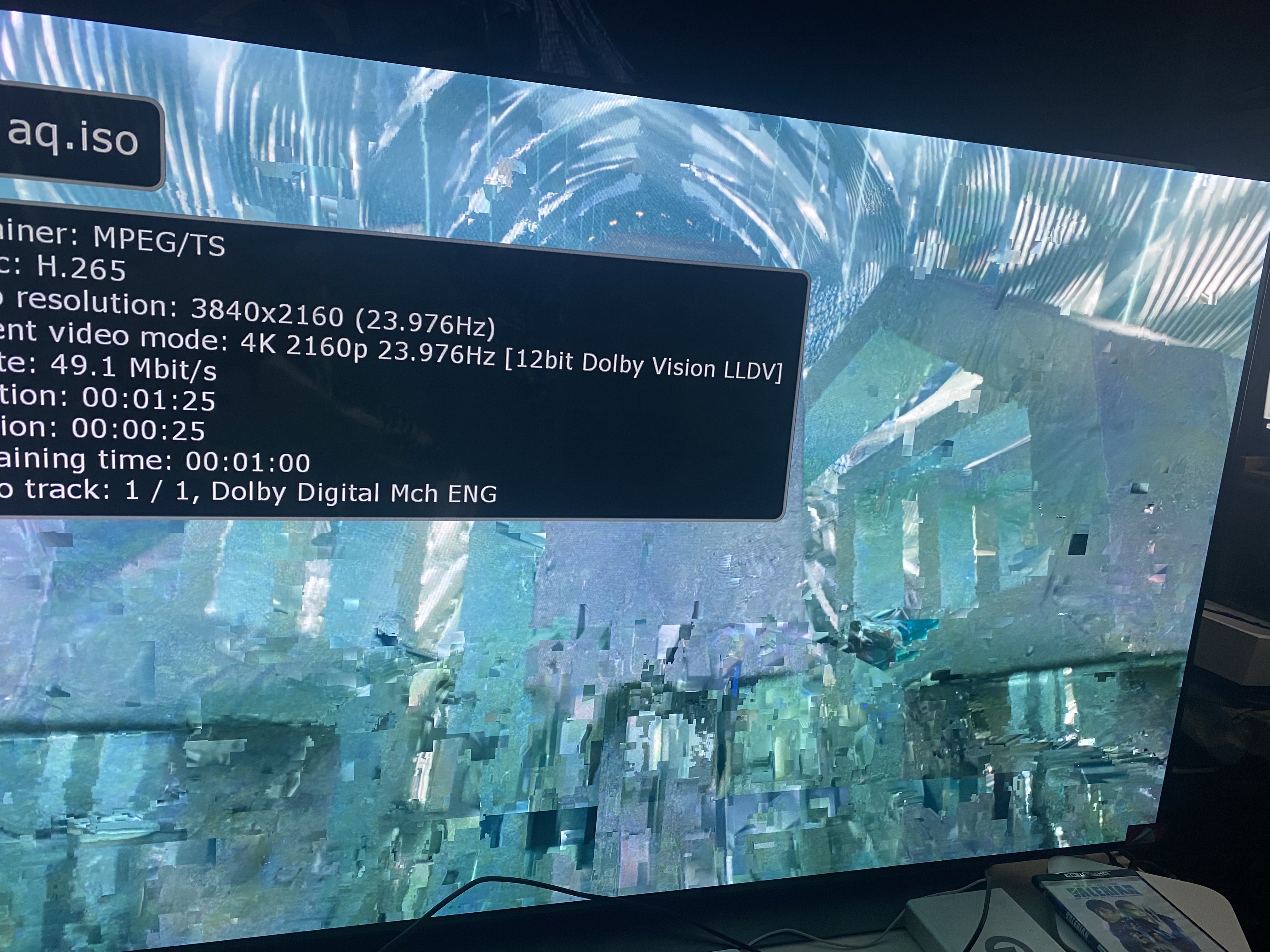

Did anyone with a dune try kodi dv build ?regular xbmc does hdr fine on the dune.
Tested aquaman el test works on dune
Used tsmuxer on the mp4 I see the errors and lum shift only in iso mode to lite but has to be iso
According to the test file the dune is processing the el
quote:
Last edited by Manixx2020beyound on Fri Feb 26, 2021 12:59 am, edited 5 times in total.

    Post by Manixx2020beyound »
    Processing the el
    Aquaman is MEL
    That's just a glitchy file
