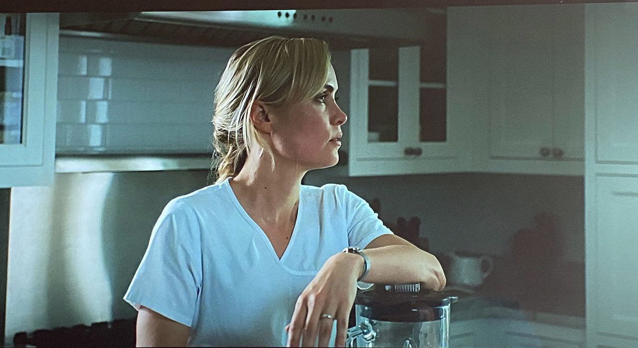

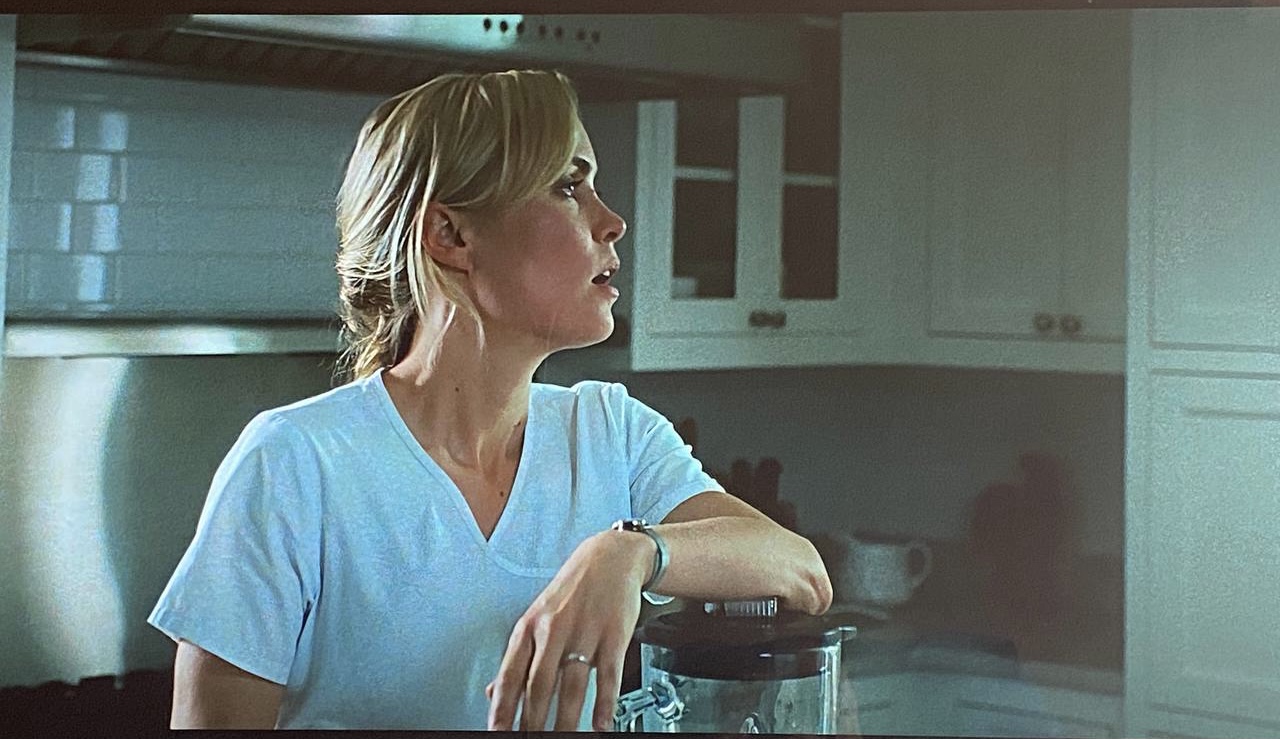

Dune HD Pro Vision 4K Solo vs Chinoppo - Dolby Vision FEL Test file
I don't know if the Dune processes the FEL layer correctly or not, but the file plays smoothly. The TV displays the Dolby Vision logo and it's a sharper image (Less noise).
- Chinoppo (M9201) Dolby Vision FEL Test file
- IMG_1166.jpg (277.89 KiB) Viewed 33804 times
- Dune HD Pro Vision 4K Solo Dolby Vision FEL Test file
- IMG_1165.jpg (227.62 KiB) Viewed 33804 times

Its not processing the FEL and the Chinoppo won’t do DV on those test files - has to be a dual layer m2ts or iso.

mmm, I guess you didn't read my post about the Dune FEL ISO playback comparisons @manix and I did.Romero91 wrote: Thu Feb 25, 2021 7:43 pm
The Dune does not support FEL at all and likely never will. yes, it can play the file, but it's using only the RPU metadata.

yes, they are lying.Romero91 wrote: Thu Feb 25, 2021 10:51 pm Dune's FW changelog then lie?![]()
is there a real noticeable difference between the P7 FEL and the DVS10 Engine? (RPU metadata only)?
If you see my comparison, I see the Dune with better image than the chinoppo with FEL supported at 100%.
On the other way, if the FEL layer is not really taken into account by the Dune, even if it reproduces it ..
my TV is an LG OLED, compatible with FEL, in principle? If I select "Dolby Vision Output Mode" in "tv-led", would the benefit of the FEL layer from Dune to LG OLED?
Thanks for your time.
see here https://slow.pics/c/nCcd2BlK
this is Dune FEL dual-layer p7 VS Dune single-layer P8 (rpu only) VS Sony x700 FEL dual layer p7 VS HDR10 bluray remux.
As you can see there's no difference between p8 and p7 on the Dune player and the x700 shows what FEL can bring.
about your comparison: The FEL sample file is supposed to be noisy when FEL is processed, that's the whole point of the file. The dune is clean because it's not using the FEL.
and yes, your TV can do FEL if the external player can do FEL. No matter the settings you use, you'll never get FEL out of the Dune.

Well, I'm seeing noise on the oppo picture compared to the dune picture.mattmarsden wrote: Thu Feb 25, 2021 10:53 pm Pretty sure it doesnt in mp4 which is why that photo from the Chinoppo isn’t showing the FEL noise, but I don’t have anyone and can’t 100% remember.
