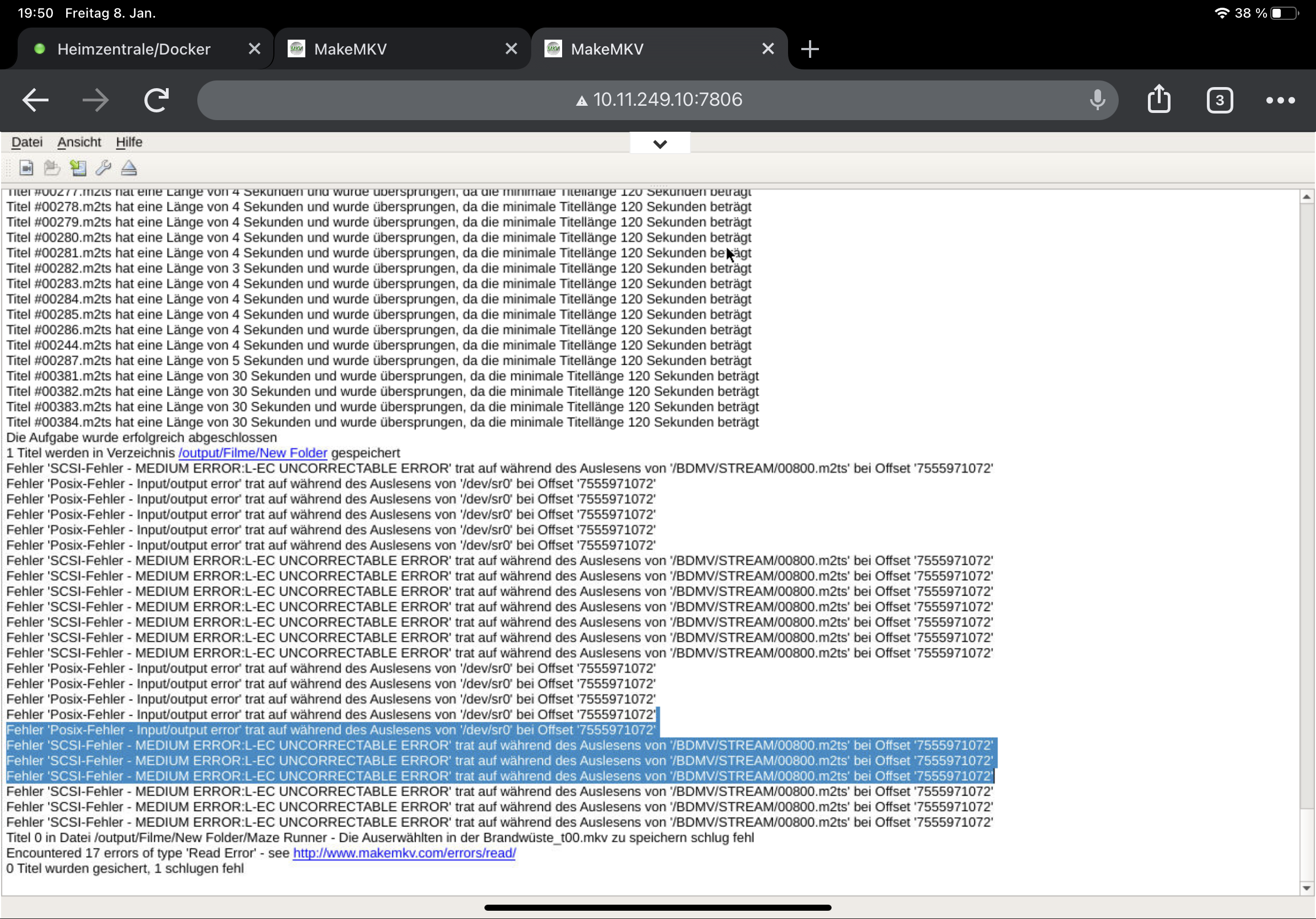

Maze Runner: The Scorch Trials (Blu-ray): I get the following messages (Screenshot). The disc is flawless, there are no scratches.
The Rip Errors FAQ: viewtopic.php?f=8&t=15055
Those errors indicate that the optical drive was unable to correctly read the disc. Even if the disc looks flawless and even if it plays in a blu-ray player. MakeMKV is trying to make a perfect copy of the bits on the disc.
The FAQ linked above has suggestions for things to try. In my experience, it comes down to cleaning the disc and trying again (perhaps cleaning the disc and trying to rip twice or three times). Also, trying in a different drive if you have one. In my experience, some discs just don't get on well with some drives. I have two drives I use. If a disc doesn't work in the first drive, I try the other. Often (but not always), it works fine.
