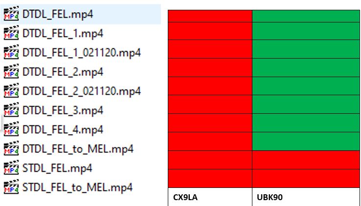

I made 3 version of Ryan: DV DL, DV SL & HDR10: https://drive.google.com/file/d/1NK71Ck ... sp=sharing
you can try yourself
UBK90: DV DL correct, DV SL pumps
CX9LA: DV SL + DL much to dark + pumps.
