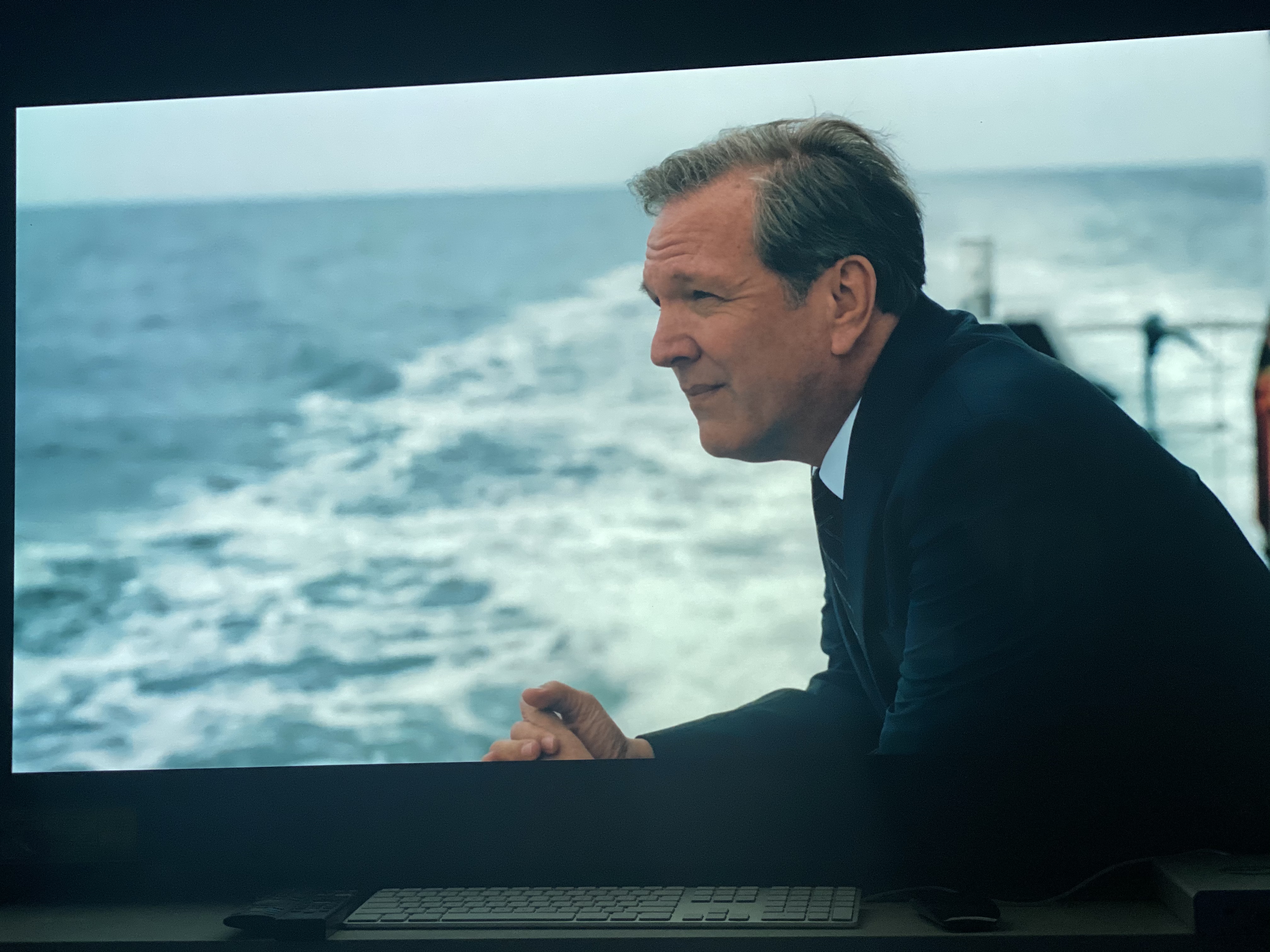

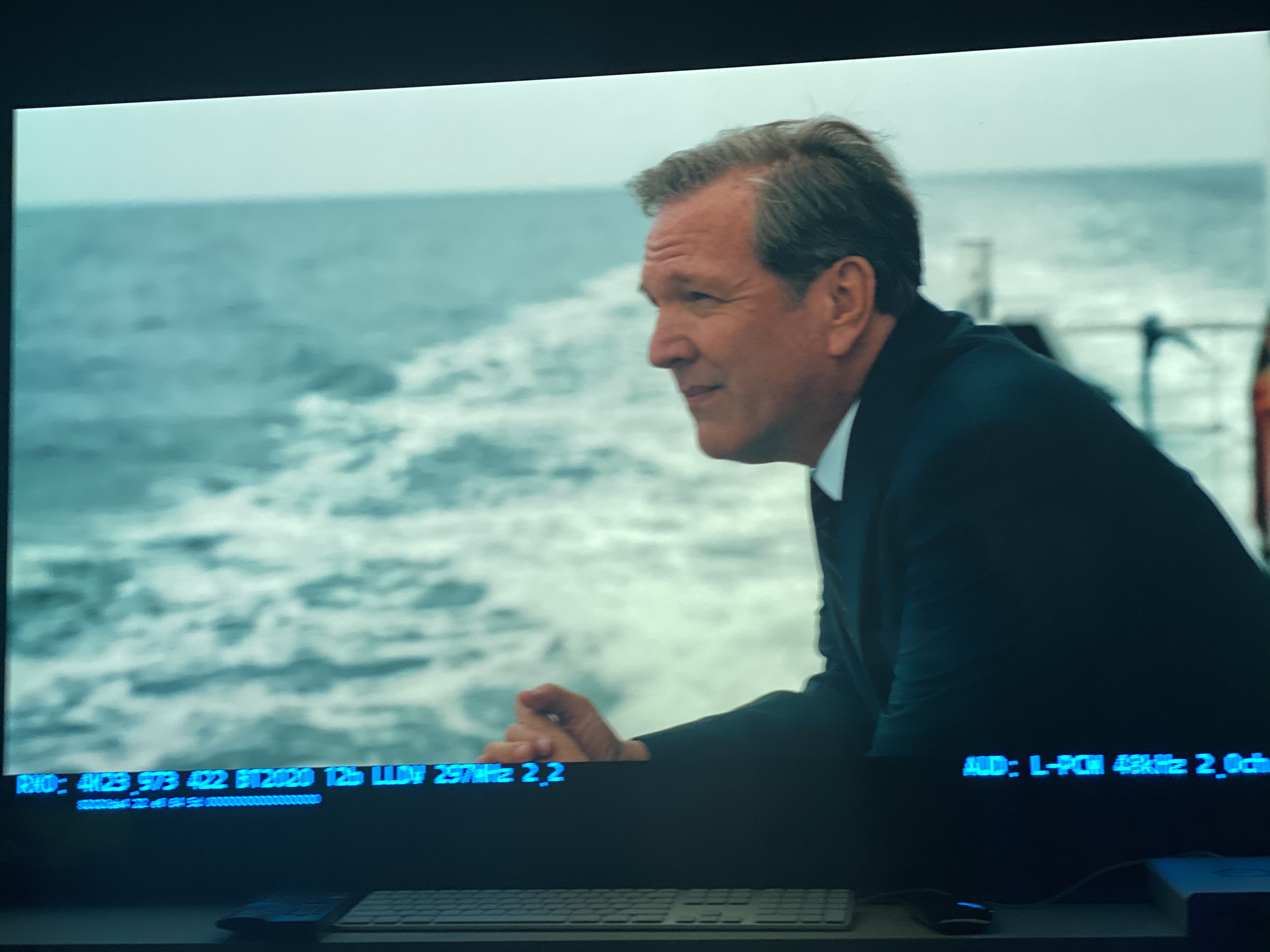

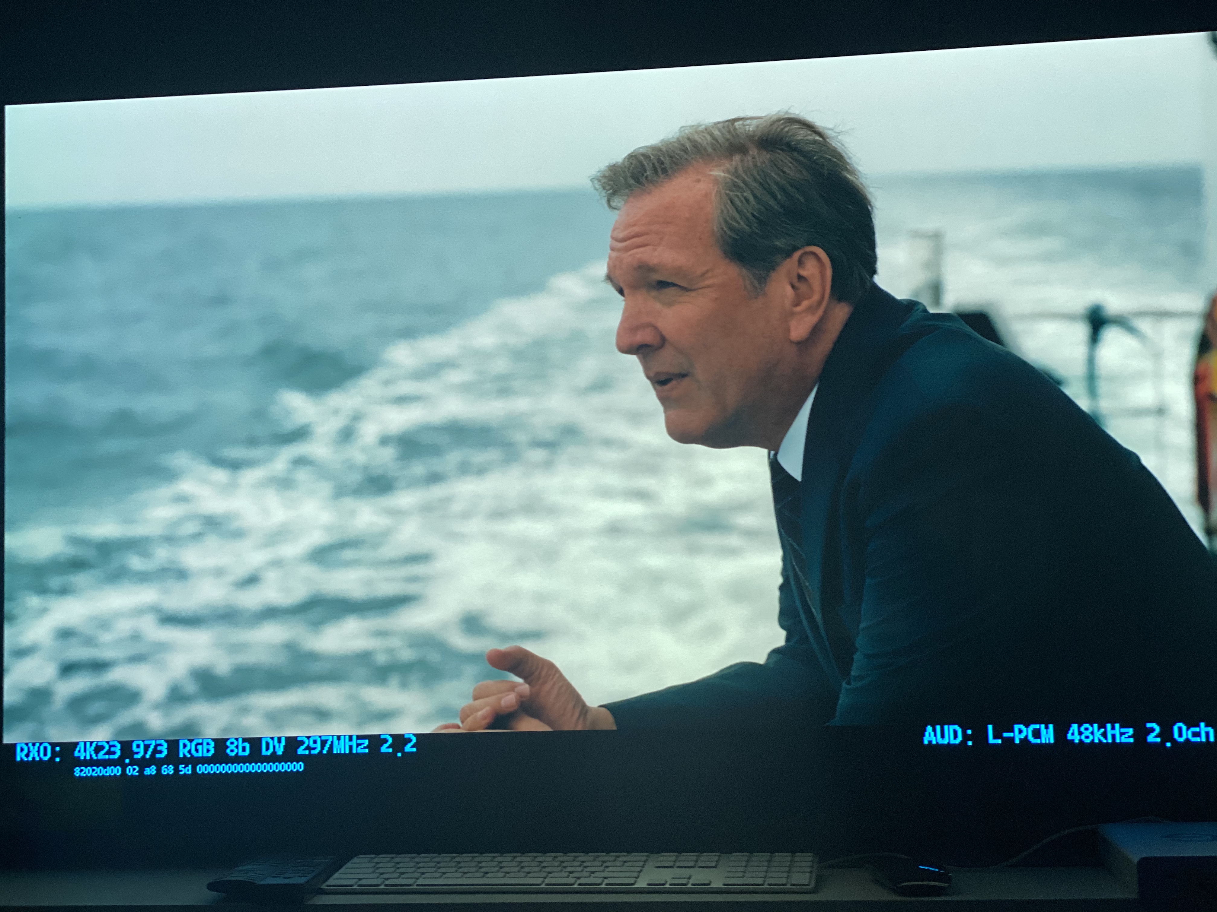

Manixx2020beyound wrote: Wed Dec 30, 2020 2:35 am
RESET_9999 wrote: Wed Dec 30, 2020 1:22 am
pete19 wrote: Wed Dec 30, 2020 1:02 am you need to use p7 with FEL in order to see differences - because the "problem" occurs when the EL is merged with the BL, and in LLDV this is done by the player/source and it won't be as accurate as tv-led
p5 does not have EL
Ok,
but the Shield is not capable of displaying p7 properly (or any other format than p5), so that comparison between the Shield and the x700 cannot be done (well it wouldn't mean anything).
Also, are you saying that MEL would look identical in player-led and tv-led ?
U would have to do x700 fel LLDV vs x700 fel rgb dv8 to see if that’s true.
tNet doblyvision shield
LLDV vs rgb8 Dolby
Rgb/8bit dv shield
Rgb/8bit dv shield
LLDV/hdr10
LLDV/hdr10
LLDV shield
LLDV shield
afss_br
