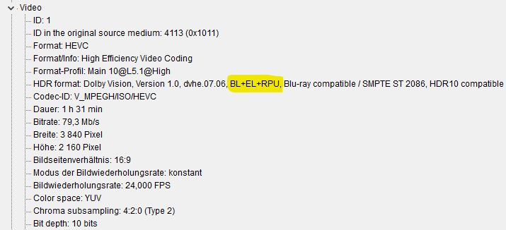

someone has an idea, how can I extract:
-HEVC1 in 4K (Base layer)
-HEVC 2 in 1080p (DV EL)
from this mkv:
with gMKVExtract I get only one *.hevc file.
I need to create a mp4 for my LG TV:

agneva wrote: Fri Dec 11, 2020 12:55 pm Hi,
from this mkv:
there is a demux bat here
https://www.makemkv.com/forum/viewtopic ... 970#p96282
