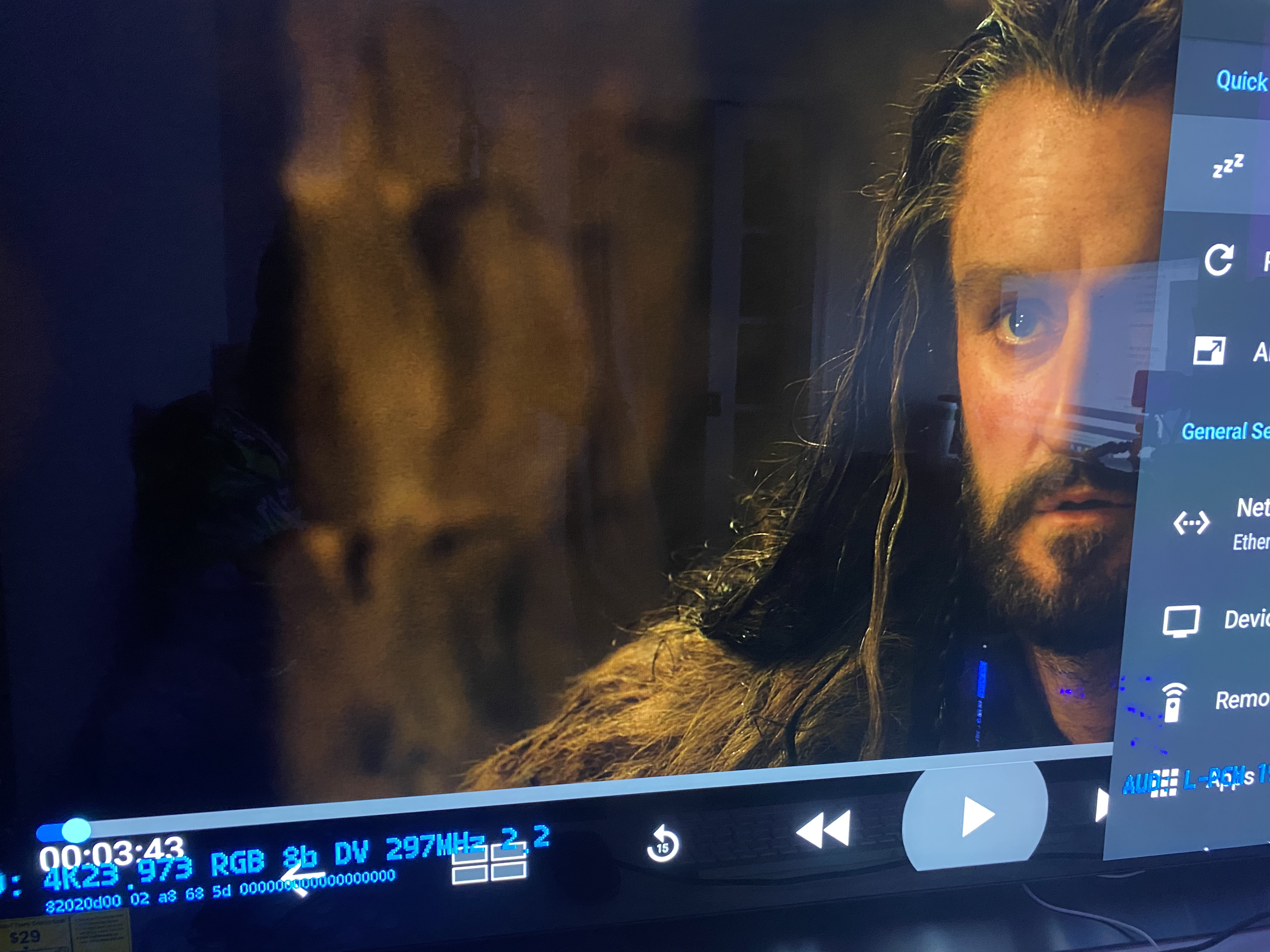

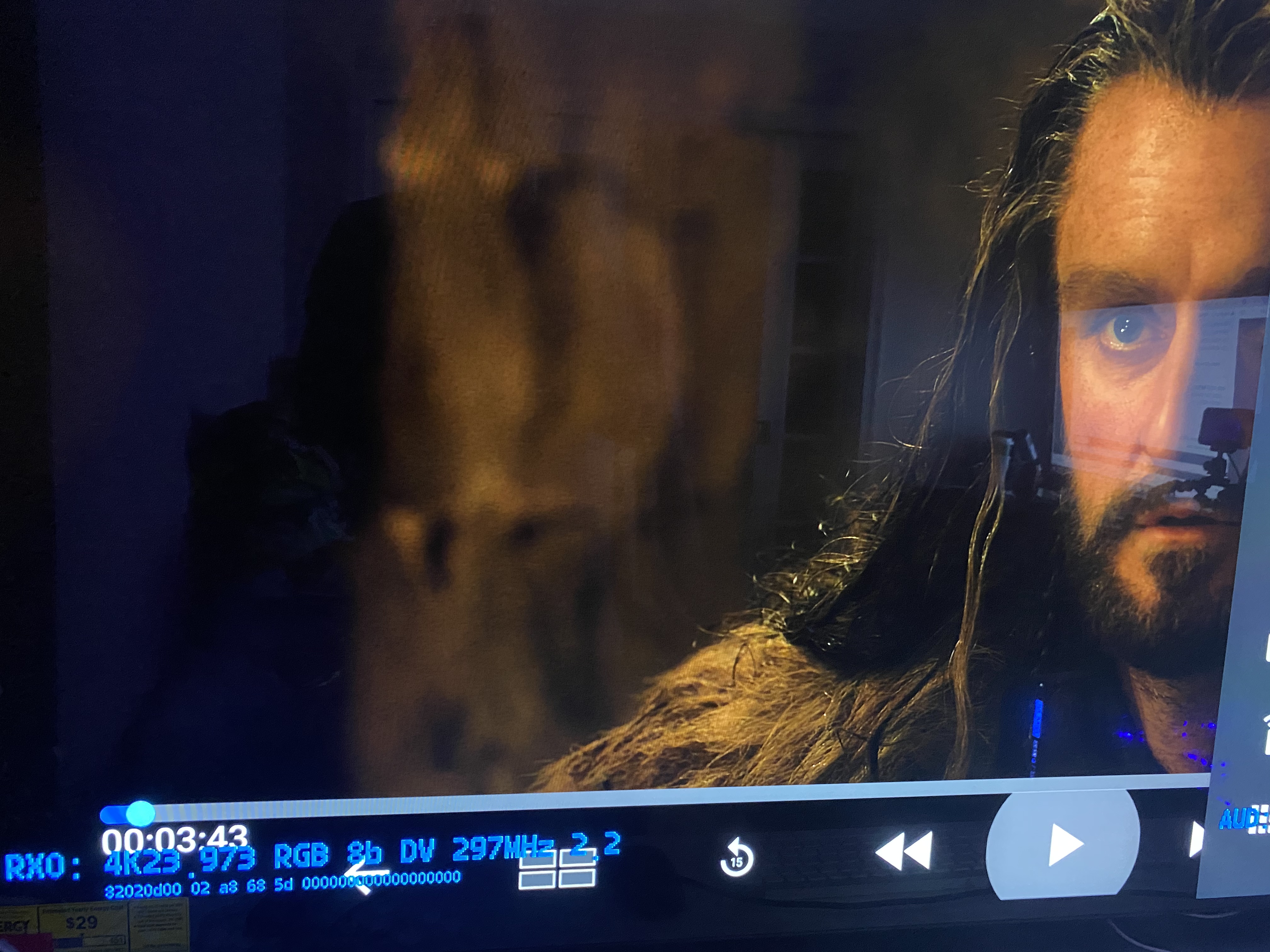

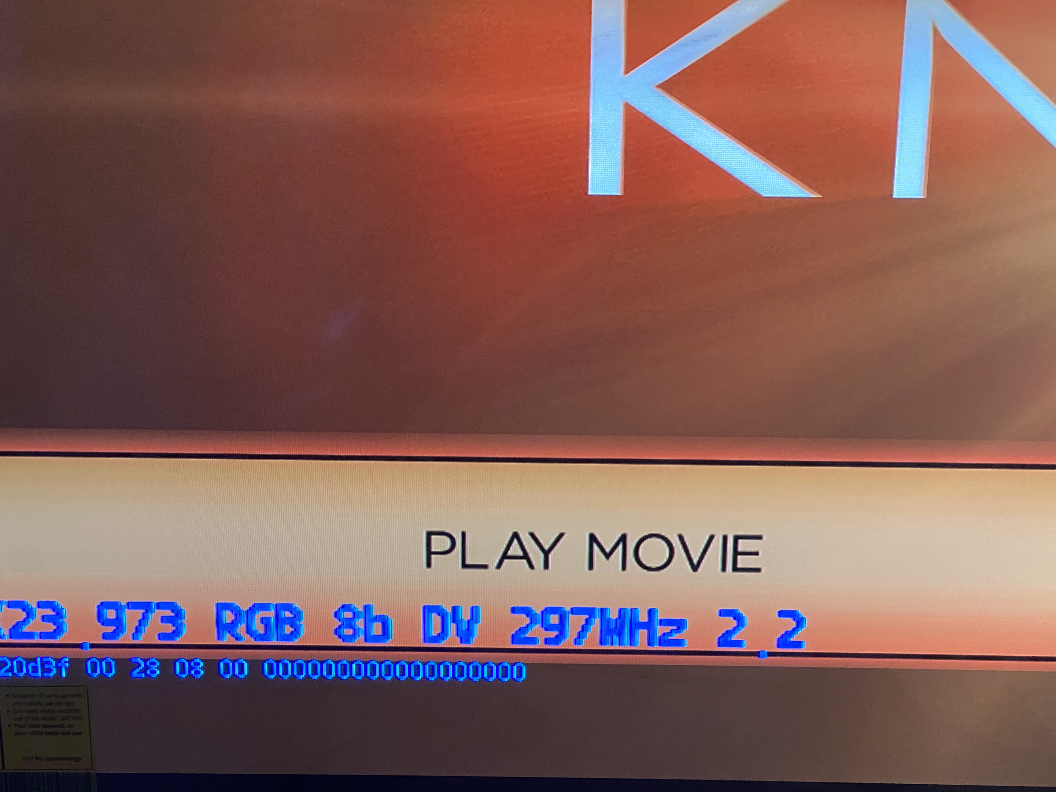

Sony /cx
X700rgb-8
X700rgb-8
Has to be CX/shield hdmi hand shake
On the CX shield behaves like the new Xbox that’s weird makes it own adjustments & CX sees it as a gaming machine, deep colors prompt u to turn off ect
This never happened to me before CX is only 3 weeks old taking the CX out off the equation & directly connected the shield is still not gaving me rgb8 dv from the shield
Even on my other doblyvision TVs.
Lol maybe my shield is broken lol
LLDV on shield is still good.
I’ll wait for other CX/shield owners to respond.

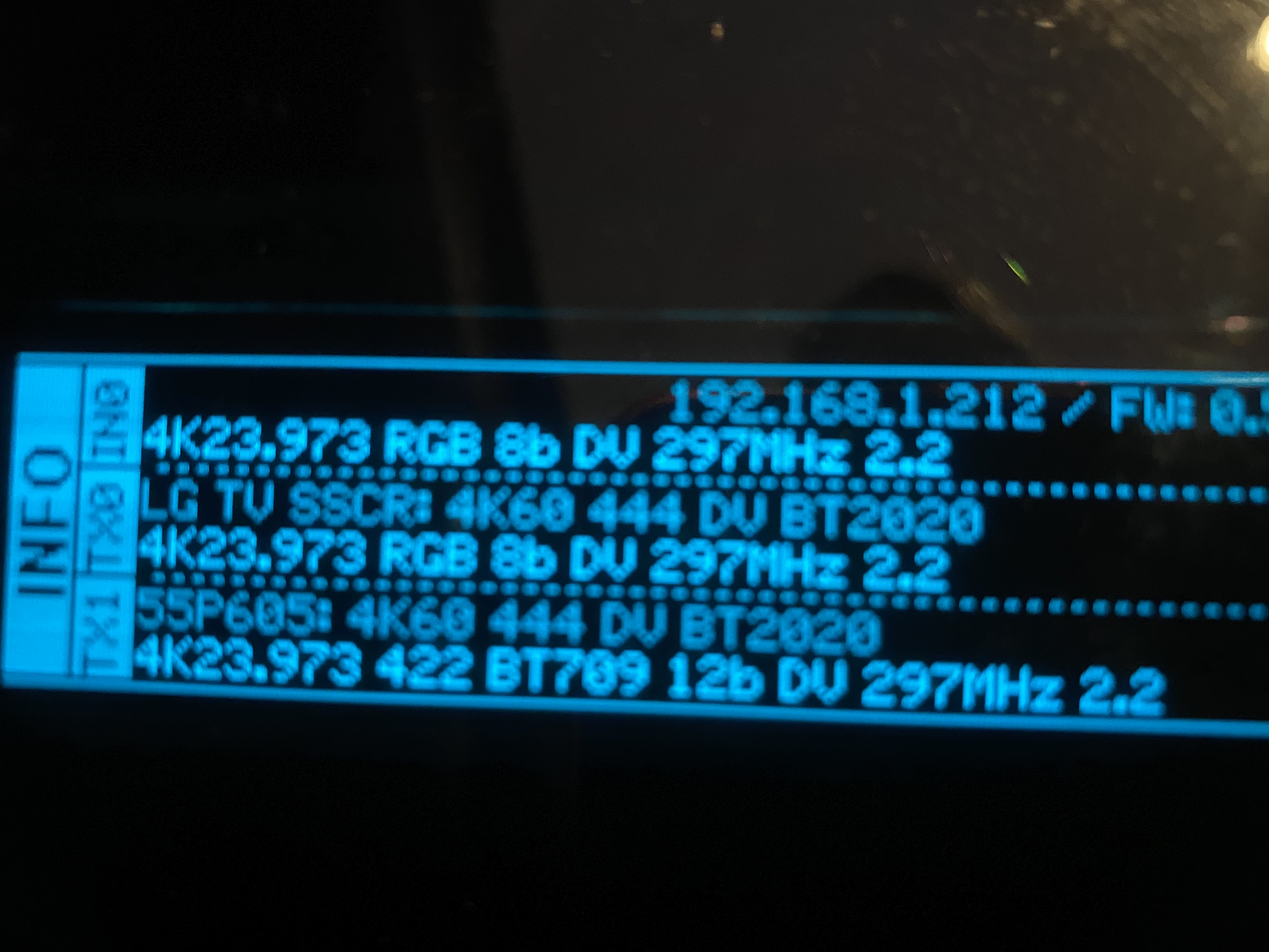

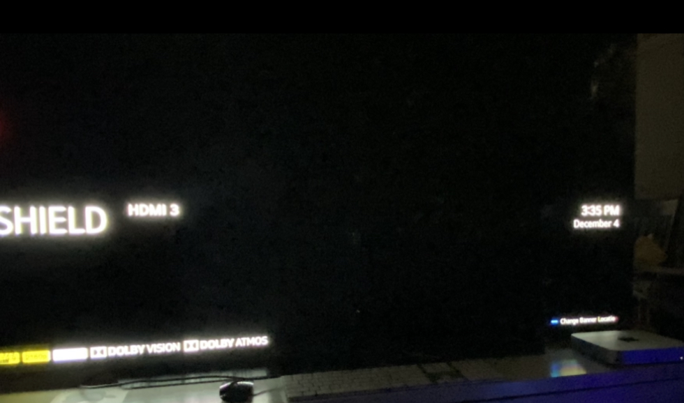

Post by Manixx2020beyound »
This is what it displays now of course I have to edit setting on the vertex to<br />To copy shield edid tx0
Got it to work very strange behavior indeed
I think it was my vertex2 it replaces the edid so a lot of times when switching back & forth between settings edid gets locked 🔒 in, powering down everything un plug still works lol.
Only difference this time my other 3 screens are gettingshield CX rgb8 doblyvision perfect shield second screen tlc black screen like the CX was getting 3rd
Screen vizo what the CX was getting before
12bit 709
But all this started happening recently well today ,it’s probably 2.1 hdmi in the loop
Last edited by Manixx2020beyound on Fri Dec 04, 2020 11:12 pm, edited 3 times in total.
