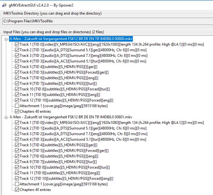

As done with Salt I extracted all tracks with gMKVExtractGUI:
2019-07-21 00_25_28.jpg (115.7 KiB) Viewed 34880 times

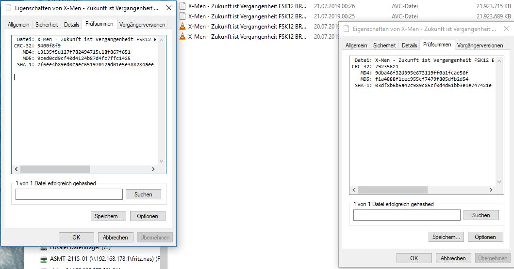

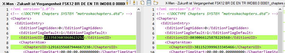

I checked all file hashes of the extracted audio, subtitles, video files, etc. by using HashCheck Shell Extension and everything has the same hash except of the chapters.xml file and the video files itself. The chapter file has identical time stamps. It has only different EditionUID and ChapterUID. I do not think this is important for us:
2019-07-21 00_34_08.jpg (61.36 KiB) Viewed 34879 times
