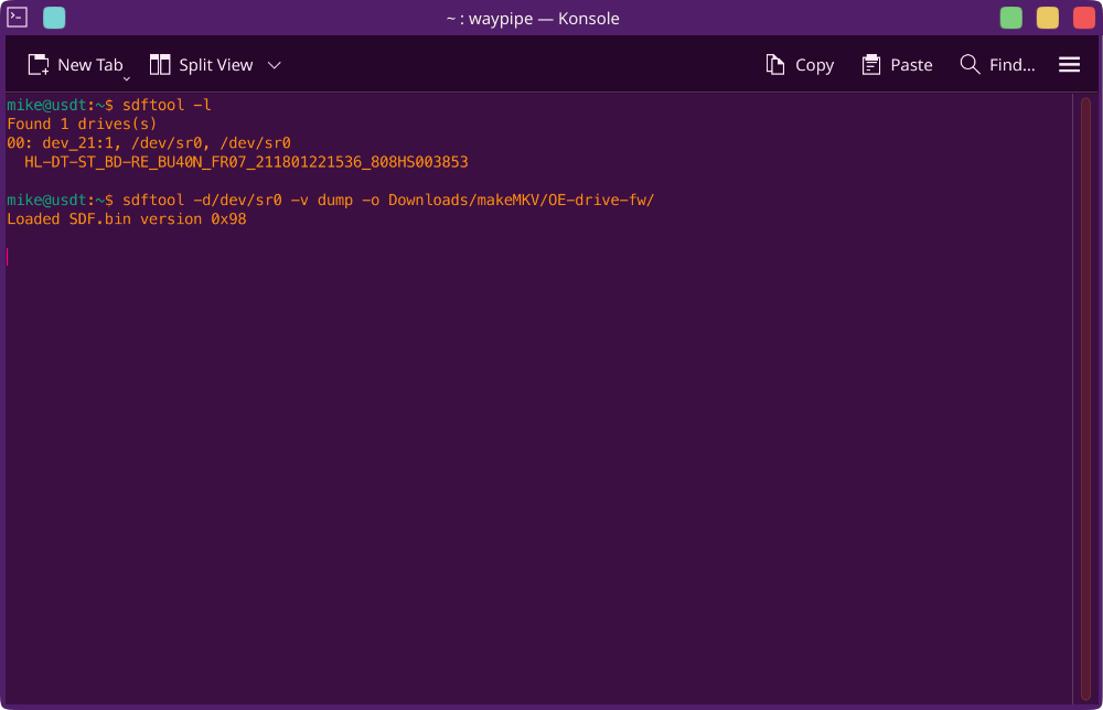

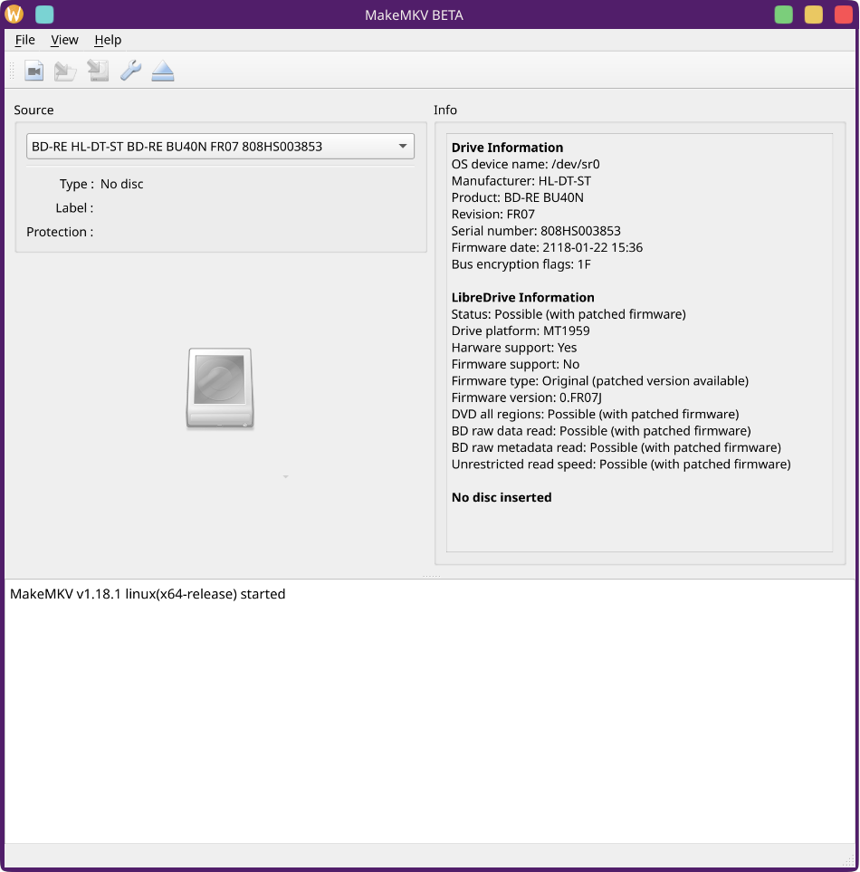

Hello, I am trying to use makemkv with a LG BU40N
I have installed makemkv on fedora linux, and all appears well. The trial key is currently outdated, and the order page is dead, so Im using faketime to get around the registration check. I've added my user to cdrom, and am using waypipe as the mediaserver has no displays.
Running makemkv (with: faketime 'last fortnight' makemkv) my drive appears to be a typical OEM drive
makemkv gui information
However, attempting to dump the drive's firmware just hangs forever (well, atleast several hours):
sdftool hang
sdftool hang
I cant figure out what Im doing wrong
