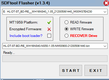

Hi guys im new to blu rays i purchased the 16NS40 from amazon all ok it came with firm1.05. I was reading different posts recommending different files.Tried MK 16n60 1.02 but gave me issues so I came across this firmware file, on another post. The process settings in image below with SDFTool. I went with the default settings and did not check the encrypted tick. It seems to have done the job. Do not have 4k disc yet but will have coming days to test. 1080 discs work fine so far. Was my process correct did i need to tick the encrypted button or ? Alot of questions i know.
Thanks pictures included
Settings used for sdftool

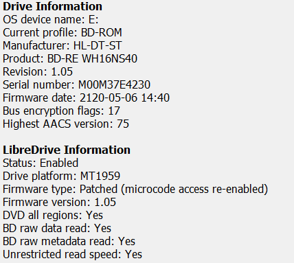

firmware now
firmware now

thanks for all the replies i changed out the firmware -> HL-DT-ST-BD-RE_WH16NS60-1.02-NM00100-211810291936
and all working with uhd no probs. tested flashing also with amazon
FIDECO IDE and SATA Adapter, USB 3.0 Hard Drive Adapter and works good too no issues.
