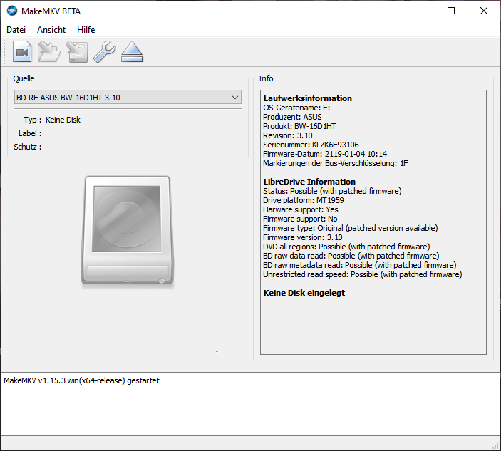

I'm new to all of this, so I just wanted to know if I have everything put together correctly so that the flashing works afterwards and I don't brick my optical drive.
So, this is what I have:
- Optical BD-Drive ASUS BW-16D1HT
- USB-Enclosure: RaidSonic Icy Box IB-550STU3S
- latest MKV-SW which tells me the following about my drive:
- Flashtool which I found via your links (patched official MTK flasher?)
- Flashfile from the MK firmware pack which would be "ASUS-BW-16D1HT-3.10-WM01601-211901041014.bin"
is this all correct and I can procede to flash?
Posts: 5655
Re: Check before flash operation
Yeah looks good go for the flash
