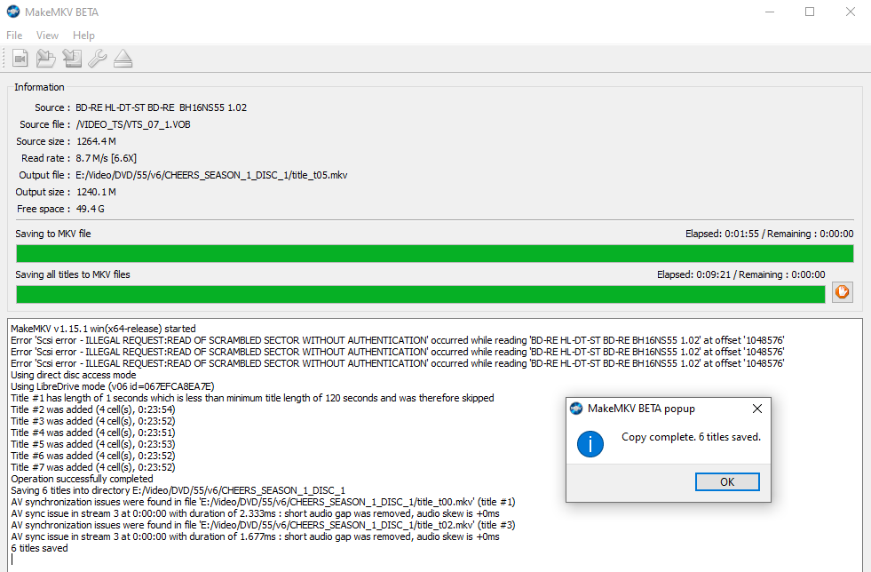

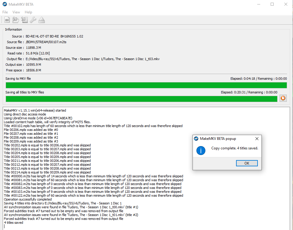

here are my test results on three LibreDrives (v5 vs. v6) done with two discs:
0. DVD9 + BD50

2. LG BH16NS55 (original firmware v1.02 to retain UHD BD compatibility)
before: DVD 21min : 43sec // BD 30min : 48sec
OS device name: U:
Current profile: DVD-ROM
Product: BD-RE BH16NS55
Revision: 1.02
Serial number:
Firmware date: 2115-12-11 14:40
Highest AACS version: 68
Firmware version: 1.02
Unrestricted read speed: Possible, not yet enabled
after: DVD 9min : 21sec // BD 20min : 31sec
OS device name: U:
Revision: 1.02
Serial number:
SUMMARY: Ripping time was SLASHED SIGNIFICANTLY!!! (by half for DVD & a third for Blu-ray) :shock: :D :lol: :oops: :roll: :P

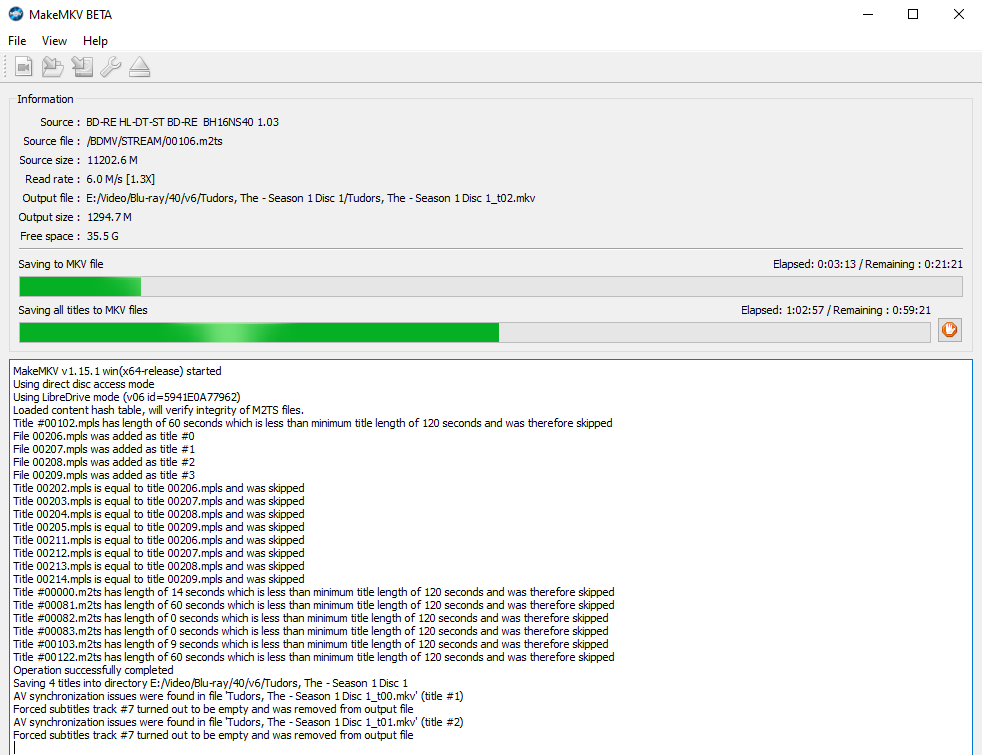

3. LG BH16NS40 (original firmware v1.03 - LibreDrive NEWCOMER)
before: DVD 16min : 55sec // BD 31min : 06sec
OS device name: B:
Product: BD-RE BH16NS40
Revision: 1.03
Serial number:
Firmware date: 2115-05-26 17:14
Drive platform: MT1939
Harware support: Yes
Firmware support: No
Firmware version: 1.03
DVD all regions: Possible, not yet enabled
BD raw data read: Possible, not yet enabled
BD raw metadata read: Possible, not yet enabled
after: DVD 10min : 03sec // BD 120min : ??sec (aborted)
OS device name: B:
Revision: 1.03
Serial number:
BD raw metadata read: Partial
SUMMARY: Ripping time greatly improved for DVD, but HANDBRAKED for Blu-rays (despite multiple trials) :wink: :(
v6 - BH16NS40 - Bluray.PNG (65.47 KiB) Viewed 30830 times
